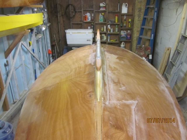

Postby herbt on Tue Jul 08, 2014 11:06 am
Attached are a couple of shots of the keel shoe I added to my pocketship. I decided to not try to add it to the CB Trunk area in order to provide a space for air circulation when the boat is sitting on a trailer. The CB trunk turned out to be stiffer than I thought it would with 2 layers of glass on it. The shoe is made of 1/2 inch mahogany scrap left over from the rails. I also added 4 inch tape to the keel/hull joint. The glassing is not complete at this point so still looks a little rough. Eventually the bottom is going to be finished in graphite powder mixed with epoxy. I really dont expect to have to replace the shoe so it has been bonded on with epoxy and glassed with 4 inch tape. If it ever does have to be replaced it can be easily ground off.
Herb
