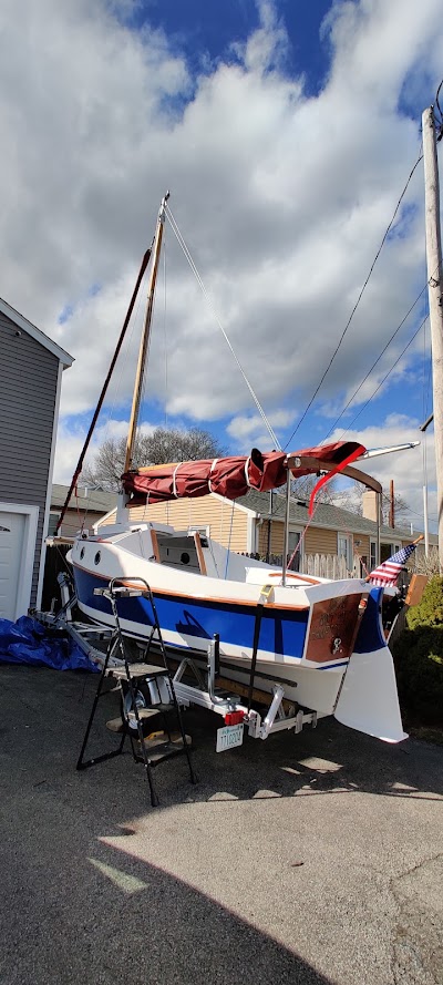

Postby afairaizl on Sat Mar 11, 2023 11:28 am
First thing this morning when we planned again to move from the garage - more snow... It caused a delay the last round of storms that rolled through dumping snow across the US
https://photos.app.goo.gl/kuRooYBnXiNSUTbE7
We went for it anyways. If she's not watertight by now, she's not meant for the water.
https://photos.app.goo.gl/HvNAnLJgw1M7iVdh7
Safely at home on the trailer
https://photos.app.goo.gl/ponnXyuNnnwXpZrWA
Time to start cleaning up some things to prep for final rigging - once it's warmer again outside. We've got another Nor'easter coming through next week.
https://photos.app.goo.gl/SSxWm2xdGU3XxeHx5

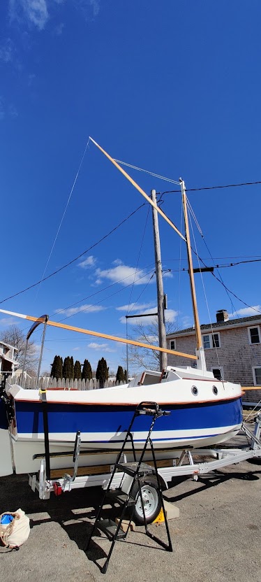

Postby afairaizl on Mon Mar 27, 2023 7:57 am
All electrical is done and tested, Rigging is complete and functional. Just need to get the appraisal, safety inspection, and try for the insurance once more. I'll probably do one polish on the hull and then add this year's registration and the letters to the bow. First splash will be in a lake before hitting the saltwater regularly.
Wind Transparent sails in place - verifying rigging during 30 knot gusts and sub freezing temps
Getting really close!
