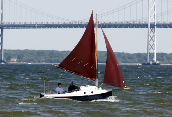

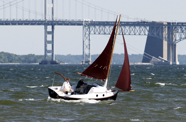

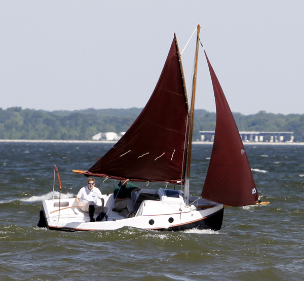

From Saturday, May 15, 2010. OkoumeFest, the CLC rendezvous, near the Chesapeake Bay Bridge. Reefed down and hustling along in 16-20 knots and big chop.

>>>>>John can you give your impressions on how she handled, on the wind off the wind down wind, boat speed, ballast, weather helm etc. I would appreciate your candid thoughts. Jeff
Going into my third season now with the boat, I've seen a good bit of wind and wave.
The boat heels right down when lightly loaded. I think the manual indicates 160lbs beneath the floorboards; if you were always solo and not carrying much gear I might suggest 200lbs instead. In big puffs the boat heels right down to the rail and sort of stops there without going any further, which doesn't hurt anything, but it isn't the fastest way to sail.
No non-planing 13-foot waterline boat is going to be dazzling upwind in chop, though PocketShip does well as long as you keep the jib set. PocketShip will surf in conditions like those shown in the photos. A long reach on a day like that would be exhilarating. Like all sloops, the boat feels, and IS, sluggish sailing upwind under main alone. Once or twice I've wondered if a 30% smaller jib wouldn't be handy for heavy air. I think the hassle of changing out jibs would outweigh the benefits. Perhaps it could be hoisted on the spinnaker halyard so you could leave the 100% jib furled and hoisted.
PocketShip almost never has any weather helm under any conditions, which is really unusual for a boat of these proportions. I worked hard at that! In the photos you can see that the tiller is amidships even when the boat is heeled sharply.
PocketShip loves waves and the (relatively) fine bow pushes through admirably. A bunch of people commented on that at OkoumeFest. Dry, too---not much spray.
