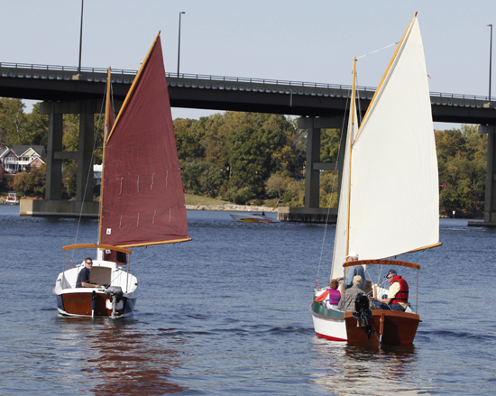

Pete M. launched his PocketShip on Saturday in beautiful late Fall weather here in Annapolis. When I heard he'd be launching nearby, I HAD to hitch up PocketShip #1 to join in the fun.
After the usual rigging fuss associated with all first launches, we got underway in 5-12 knots of breeze and sailed for an hour or two in company. Either his boat is faster than mine or he caught all the lucky shifts, as he opened up quite a lead during a few puffs. Thanks to me getting my outboard bracket not-quite-right, I was dragging a little bit of my lower unit, which probably gave him an advantage. I know that sailing with another nicely-built PocketShip pushed all of my competitive buttons!
Pete's PocketShip bears hull number 15. Looking forward to more hulls in the water so we can have a proper race, or at least a friendly rally.

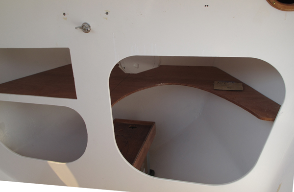

One of many features I liked on Pete's fine boat was this mid-height shelf in the forward locker, which makes that large space easier to organize.

Replying to "Dave C." -- The engine is a Tohatsu 6 hp with extra long shaft especially for sailboats. The tip of the shaft (just below the propeller) is about an inch below the rudder winglet. I took her on a motor breakin cruise a few days ago and at about 80% power (4,000 rpm) she pushed Tattoo at just over 5 knots by the gps. For a short run at 5,000 rpm, it bumped up to about 6 knots. The 5 knot figure was an average both with and against a slight tide. I didn't try the 2 minute run (at 5,000 rpm) in both directions, ... so it may include some of the tide. Probably does, because I think PocketShip has a hull speed of about 5 knots. I made a cutout on the beautiful transom down to about 3" above the cockpit deck. It really hurt to make that cut. I saved the "cutout" just in case I want to put it back. I glued a 3/4" x 6" tranverse doubler (wood: ash) to the inside of the transom before installing the deck. The engine clamps to this doubler, the transom, & a laminated maple pad). I chose the cutout rather than a bracket because the only brackets I could find rated for 4-cycle engines cost about $300 to $500 and were heavy and ugly. Well, hanging any engine off of a beautiful sailboat is ugly, so why have an ugly bracket as well as an ugly engine? I have a long-shaft 2 hp Honda 4-cycle that I'll try next. Its "long" shaft is about 4" shorter than Tohatsu Sail Pro's extra long-shaft and that still might be deep enough. But the 2 hp is only 29 #, vs 59 # for the 6 hp. Later, I'll post some pictures and sketches of the set up.
