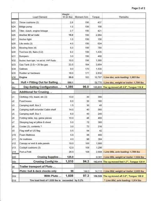

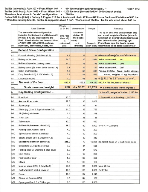

After some off-season repairs and modifications I have recalculated Tattoo's weight and balance. Attached are the two separate pages in "jpg" format. If any [of you] would like to have it in "pdf" format, just let me know and I'll email the file to you. Also, if any of you know how (or if it's possible) to upload a "pdf" file on the Forum, please let us all know.
W & B pg1.jpg (177.9 KiB) Viewed 9586 times
W & B pg2.jpg (142.16 KiB) Viewed 9496 times
