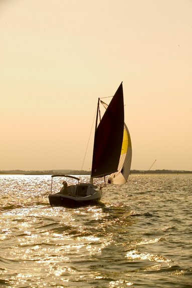

I and others have sailed up and over 7 knots on the GPS lots of time in the right conditions. The boat seems to be operating at an S/L ratio of higher than the usual 1.34, probably because of the relatively shallow body and clean run aft (more or less inspired by the Snipe racing dinghy I grew up in). I have noted that when sailing in very heavy air with three adults all sitting to windward, the boat is capable of a truly startling burst of speed. (Before witnesses I once paced a Caledonia Yawl upwind.) From the shape of the wake in those conditions it's clearly starting to climb out of purely displacement mode.
This is still a cruising boat with a ballast keel. It'll definitely surf in waves in the right conditions, but it's never going to climb out and plane like a 470. With the spinnaker up and a fairly heavy crew to keep her upright you'll get an exhilarating broad reach.
