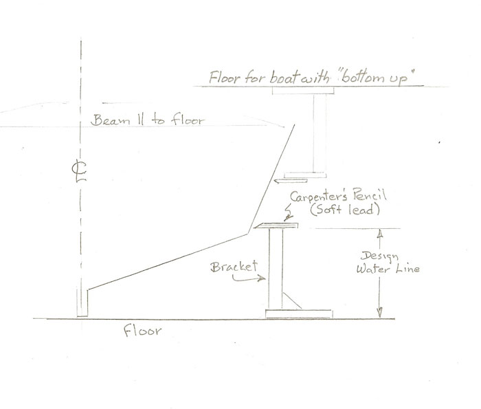

Captian Charlie -- I've put waterlines on 4 of the 8 wooden boats that I've made. On Anna, my Penobscot 14, I tried to use a laser level -- but I didn't have a surveyor's tripod and couldn't make a sturdy exactly-level platform. Also the laser wasn't bright enough to easily see its projection. And you have to duplicate the setup on the other side of the boat. I gave up on it. My alternate method has worked well for each boat. You do need a level (or at least "flat") floor to work from. And it is easier to scribe the line on the boat when it is upright because in that position the space between the waterline and the floor is without obstruction. I've scribed the line after the last epoxy (has been sanded smooth) and before the 1st coat of paint.
A waterline marking bracket . .
Make sure the boat is level with the floor (side to side and end to end). If the floor isn't quite level, then make the beam parallel with the floor and set the keel so that the floor is parallel with the design waterline shown on the plans. For PocketShip the keel is paralled with the design waterline. Then fabricate a bracket so that its top is the right height above the floor as shown in the attached diagram. It helps to wax the bottom of the bracket so that it slides easily on the floor. Find (and sharpen to a chisel end) a carpenter's pencil with a soft lead. Just move the bracket around the boat and make pencil marks on the hull at frequent intervals. If you are going to paint a "boot" on the waterline, then extend the bracket the height of the desired boot -- and make another water line. Then when your eye is in the plane of the water, the boot will look like it is the same height all around.
The scribed line is only temporary. I would take an old and "dull" center punch and carefully "dimple" the hull along each waterline every inch or so. If you are careful, the dimples won't damage the hull, but will show up (in oblique light) even after the paint job and can be guides for masking future paint jobs.

I just hope I can meet Pete "Tattoo" the next time I am in the Baltimore area. This guy is always coming up with great, simple ideas that work--probably has a lot to do with his aeronautical engineering background. (I still like the water-in-a-tube method best in this case, though. No construction necessary, and as long as your boat is perfectly level, the floor doesn't matter--water seeks its own level no matter what.) One of Pete's best ideas in this latest post is the small, almost invisible dimpling of the surface at the waterline--a huge help when it comes time to repaint.
