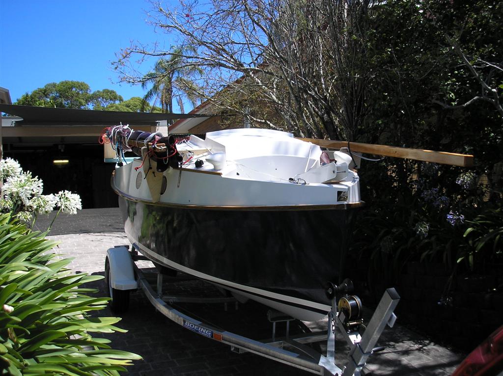

For those of you who read my comment on rigging and unrigging Sandpiper to get it into my garage, I've now put together my solution in the form of some "chocks" to hold the mast and boom/main/gaff on either side deck low enough to get in the garage. When I want to go on the road, I install the boom gallows, tabernacle, and bowsprit, lift the mast onto the tabernacle/boom gallows, and the boom etc onto the gooseneck and the boom gallows. Every shroud, halyard, and sheet is connected permanently, except for the gaff yard halyard, so it should be ready to raise the mast at the launching site in minutes. I've attached a pic of my solution (please note the "chocks" are only for the garage and driveway, not for trailering!).
Bob in Sydney

My final comment on the rigging/derigging issue regarding storing Sandpiper in my garage. My most recent outing was pretty disappointing, as I thought I had all the running rigging sorted out well on the cradles I built for the mast and boom/gaff while it's in the garage. I thought it looked a bit suspicious when I put the mast and boom/gaff onto the tabernacle before getting ready for the road. When we got to the launch area and tried to raise the mast, it was a hopeless tangle, and took longer to sort out than the first time I rigged it. After sailing, coming home to wash down and put the mast and boom/gaff on the cradles, once again it got so tangled that I gave up and disconnected the mast/gaff/main from everything, rolled it up, and stowed it on it's own. I've now given up storing Sandpiper in the garage for the future, and will get a full cover made so I can park it on the street with the mast and boom/gaff/main installed and rigged. If this had been a Marconi rig, I might just have been able to handle the complication of stowage, but the gaff rig running rigging complication has defeated me in this regard. Otherwise, I love the Pocketship.
