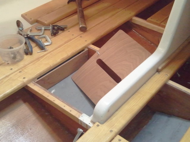

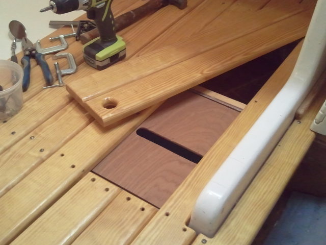

There's a fairly easy prevention that I've just installed on Tattoo, my PocketShip. I installed a "ballast restraining" baffle between floors 4 & 5 just at the inboard edge of the 5th floor plank to keep ballast close to the keel. To keep ballast under the floor boards, I installed a "ballast cover plate" that slips through the lift-out section opening and is "fixed" with a 1.25" #8 SS FHWS placed through the 4th floor plank and into the cover plate. The "ballast restraining" baffle is screwed to cleats (screwed to the floors) at the edge of the 5th floor plank and is not easily removed. But the "ballast cover plate" is easily removed for access to the ballast.
The cleats are 3/4" x 1" stock. The baffles and cover plates are left-over 1/4" marine plywood w/ 2 coats of epoxy.

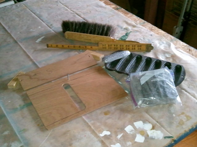

Tattoo's ballast is melted down wheel balancing weights contributed by a truck tire service center. I used a cast iron mold for "cornbread sticks." Each cornbread shapped ingot of lead weighs about 1.1 lb. Nine fit into heavy duty zip-lock bags. I use two bags for each cluster of 9 ingots. Presently, since I often sail solo, I have 11 bags on each side of the centerboard. That takes up almost all the space under the floor boards and between the centerboard housing and the baffle installed at the edge of the 5th floor plank.
The photos show how it all goes together.
Wooden parts, lead ingnots, ballast cluster in zip-lock bags.
Baffle shown installed at edge of 5th floor plank. Notice 1/4" poster board as chaffing pad against bottom plank.
2012-02-08 10.00.56.jpg (59.54 KiB) Viewed 13520 times
Cover plate installed. Lift-out section removed.
2012-02-08 10.07.43.jpg (63.02 KiB) Viewed 13521 times
