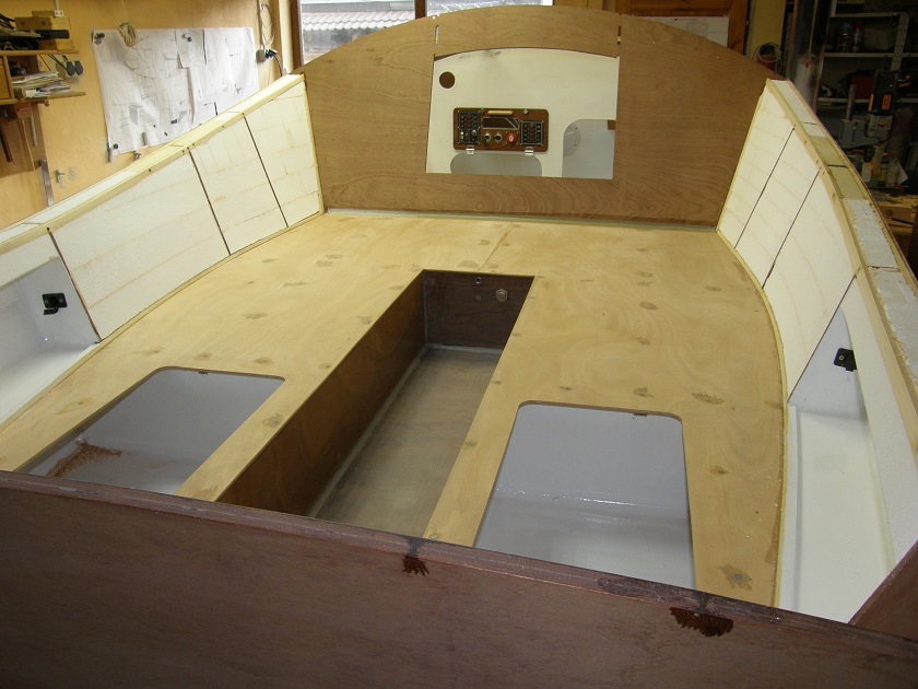

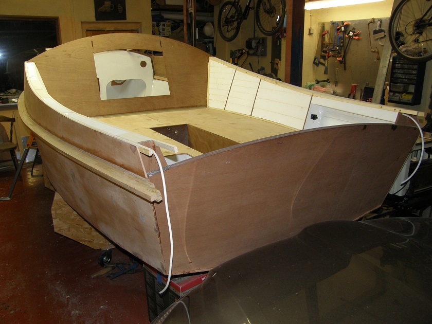

Postby hood on Wed Apr 30, 2014 4:49 pm
latest construction photos
Re: A "shoe" for PocketShip's keel . .

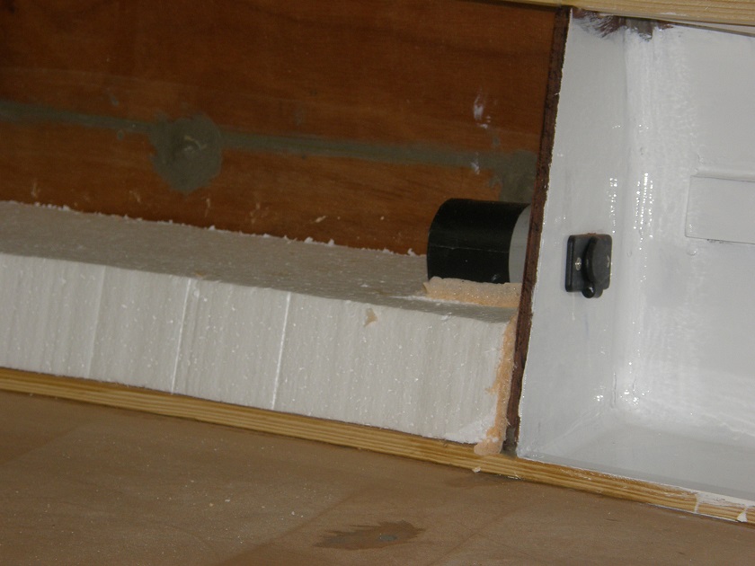

Postby Saltykid502 on Wed Apr 30, 2014 6:03 pm
What are the black fixtures to the left and right?

Postby hood on Wed Apr 30, 2014 11:52 pm
12V socket

Postby DanaDCole on Thu May 01, 2014 7:51 am
Hood, you're making lot's of progress and looks like some interesting innovations I wouldn't have the courage to try. Looking good though. I'll be interested to see how you fiberglass the hull-to-keel connection when you turn the boat over.
