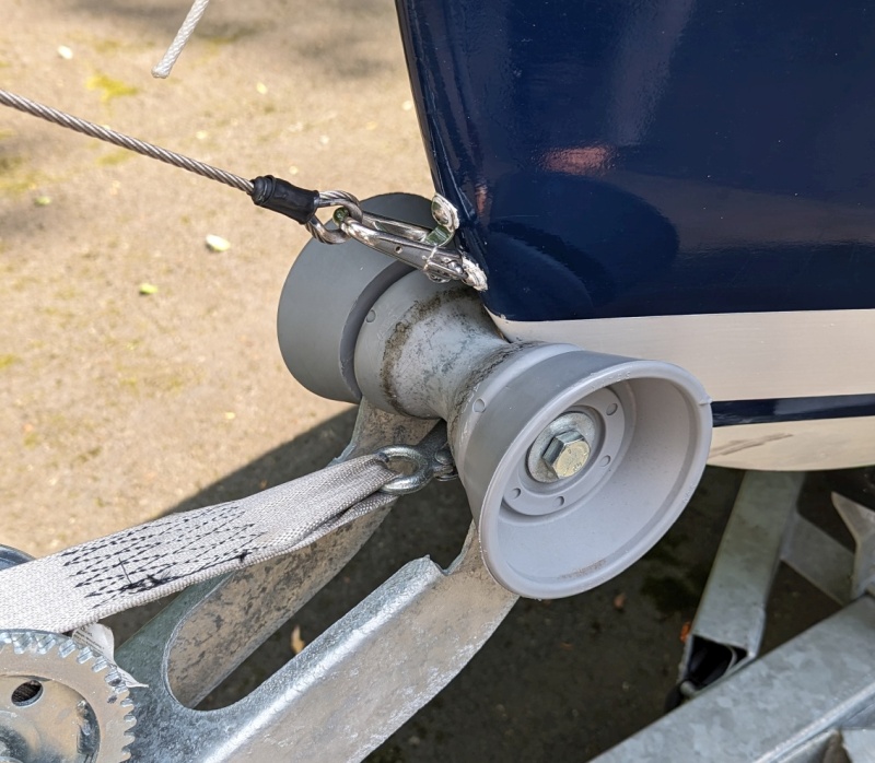

BTW, I used "Loctite PL Marine Fast Cure" for caulking the eyebolt and sealing the companionway hood to the cabin roof, and I am happy with it. It is very strong, dries fast, and Lowe's carries it.
Lastly, after my first season I installed a second eye at the bow just for the bobstay. Now I can leave it attached all the time:

More than once I had raised the mast, only to realize that I had forgotten to fasten the bobstay. Heading out with the bobstay
unattached could lead to disaster...
Re: Bow Eye install
Postby Dmksails on Sun May 11, 2025 11:55 am
Doug - how far above the bow eye did you place the bowsprit eye?
Dmksails
Joined: Sat May 25, 2024 2:21 pm
Re: Bow Eye install
Postby [email protected] on Sun May 11, 2025 5:44 pm
Dmksails wrote:Doug - how far above the bow eye did you place the bowsprit eye?
Just far enough to leave enough space for the trailer's bow roller. I had to hack away an inch or two of the flotation styrofoam
to be able to bolt it in place from behind.
