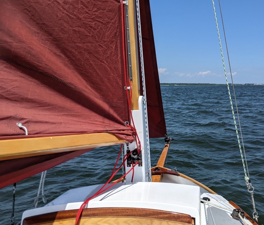

More important is the reefing set up. You really must have easy-to-use reefing, and the plans and parts list do not cover it at all.
I added the deluxe single-line setup that PS #1 currently has. (You can see it in the PC photo gallery at clcboats.com: look
for the photos labeled "This series of photos is from mid-May 2019"). This setup needs a bunch of hardware and probably
cost me about $200, but it is easy to use when things get rough.

Postby [email protected] on Sun Aug 13, 2023 6:48 pm
Here is what the setup at the mast looks like:
