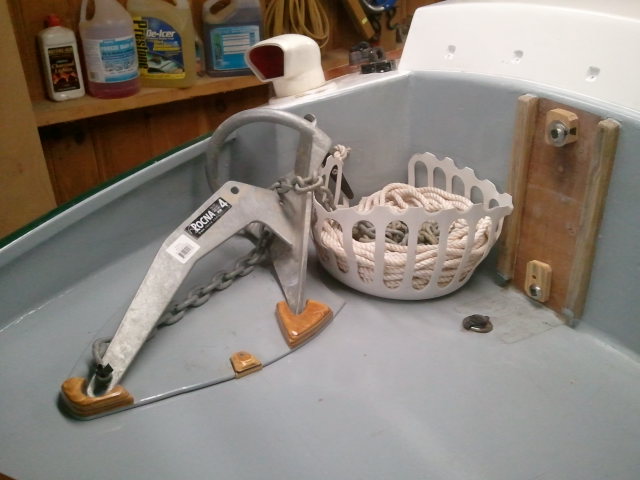

I stow Tattoo's main anchor on what I call the "anchor deck." I can deploy it by standing on a folding plastic stool in the cabin and reaching over the conpanionway hood. When deployed, the anchor rode can be retrieved with a boat hook while standing on the stool in the cabin. Recovery of the anchor itself is done over the side from the cockpit and then passing the anchor forward to the anchor deck. A little awarkward, but when on the water I try to avoid climbing over the hood to stand in the well of the anchor deck.
I made an anchor "chafing pad" to protect the relatively thin anlchor deck. It is held in place by the anchor's weight and a "dog" screwed to the deck (and bulkhead #1) and [at the other end] the corner of the Dorade box. The chain and rode is held by a plastic laundry basket that I got at Wal-Mart. The top edge was cut off.
Primary anchor on her chafing pad and chocked.

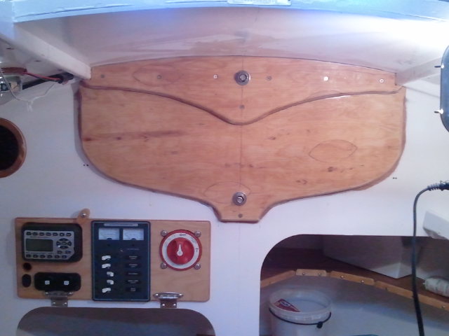

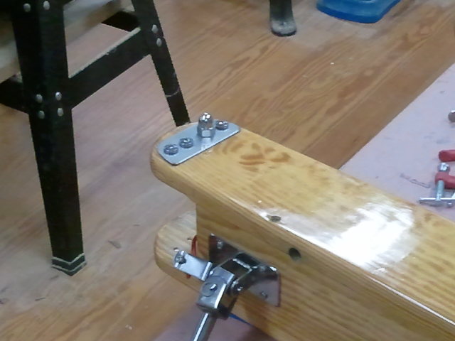

During my first sailing season I had a failure at the intersection of the #2 bulkhead and the cabin roof. The mast and tabernacle pulled the bulkhead forward (away from the cabin roof) by about 3/8". I think I may have been epoxying that joint when the temperature was too low. Also, I didn't have any fiberglass that wrapped over the cabin roof and down the outside face of the bulkhead. I've repaired it with a doubler on the cabin side of the bulkhead (see attached inside photo). Concerned about the forward forces on the mast, I also strengthened the mast pivot bolt hole with metal plates (on each side). Each is held in place (in bedding compound) with 3 machine screws that end flush with the inside surface of the tabernacle sides. I just self "tapped" them into pilot holes drilled 1/16" smaller than the screw outside diameter. The "tapped" holes were saturated in epoxy with the screws in place, then, after a partial cure, the screws were removed. After a complete cure, the screw holes are quite durable. For removable tabernacles, CLC now recommends a backup plywood plate on the inside of the bulkhead and using a 4-bolt pattern.

Doublers on inside of Bulkhead #2 . .
2011-11-13 10.42.15.jpg (52.98 KiB) Viewed 13566 times
Anti-splitting measures. Tabernacle strengthened at Mast Pivot Bolt . .
