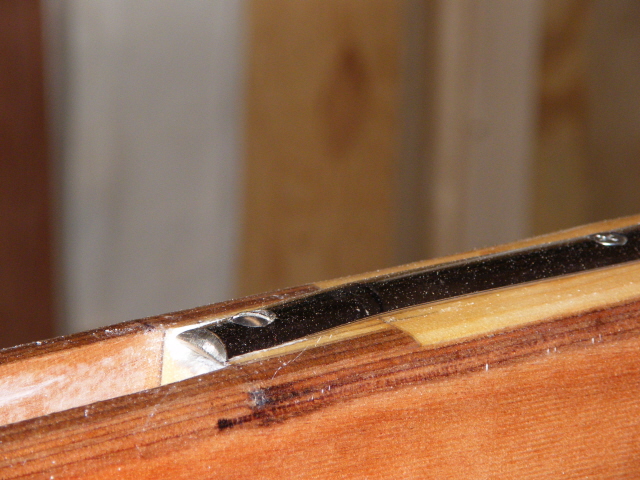

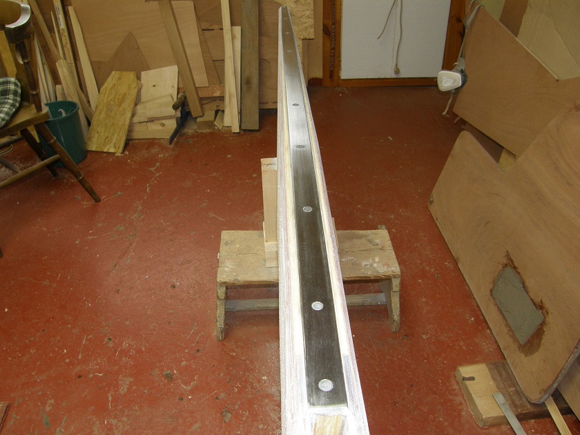

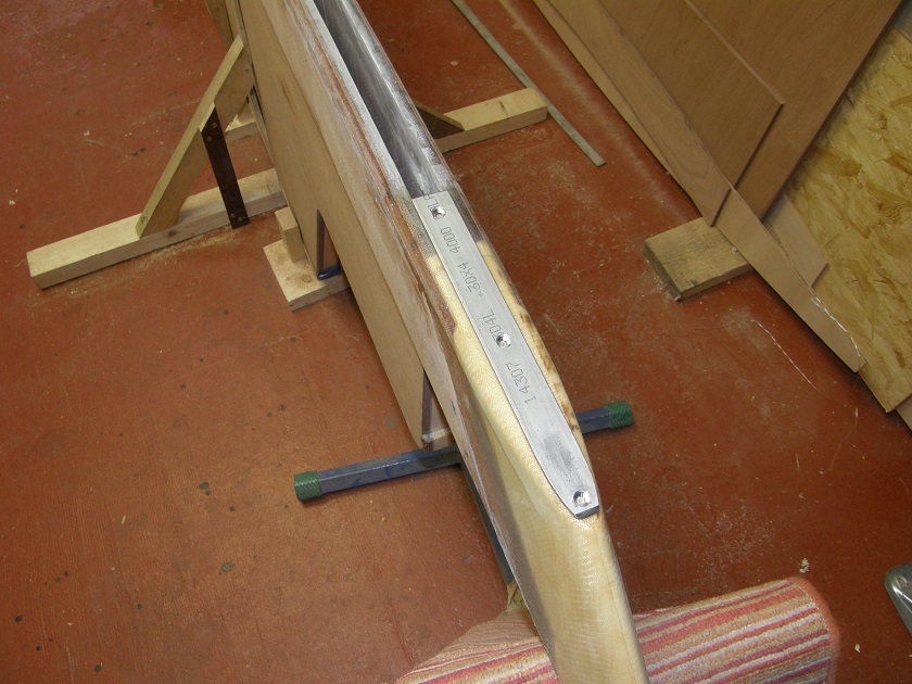

The bottom of PocketShip's keel is stock lumber covered by one or two layers of fiberglass. That keel gets draged over the centerline bunk whenever loaded on/off its trailer. And if grounded and/or beached, she may be scraped against who knows what. I wanted some protection.
So, for Tattoo, I installed a "shoe" of 3/4" SS half-oval on the keel from the noseblock to the stern (skipping the centerboard). At the leading edge of each of the two pieces, I cut a shallow (1/8" sloping) groove so that the leading edge (of the half-oval) couldn't snag on anything passing under the keel. The first inch of the leading edge of each half-oval piece was bent and tucked into the groove. She was bedded carefully with compound and screwed in place. Flat-head screws had a better profile than oval-head screws. Even so, they needed filing to keep the edges under the half-oval profile. It adds a little weight, but in the right place (down low).
Shoe between the noseblock and centerboard well.
Shoe at aft end of centerboard well.
The SS shoe showing the aft end arrangement that provides some support for the bottom eye-bolt.
