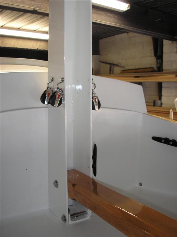

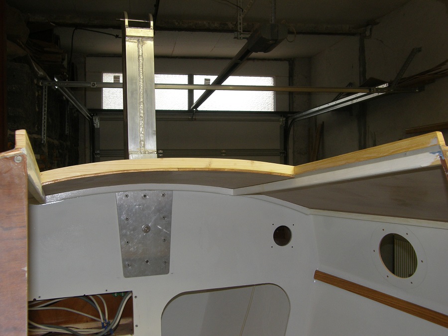

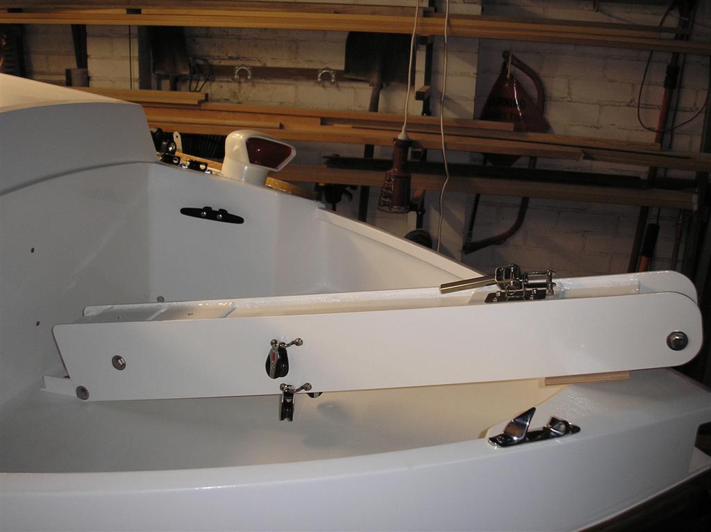

I'm currently working on an aluminium folding tabernacle due to a need to lower it to get my Pocketship in my garage on the trailer. It's basically 5mm 5083 aluminium plate, same dimensions as the wooden tabernacle, with an additional part bolted to the forward cockpit sole to act as the hinge plate. The back plate of the tabernacle will be bolted through the cabin forward bulkhead through a 10mm doubled aluminium plate about 30 x 20cm (12 in x 8 in for you Yanks). It'll all be painted the same colour as the cabin/decks, so hopefully it won't upset the wooden traditionalists too much. My Pocketship is just about at the bottom painting stage, so I should be able to install it and see how it looks in a month or so. I'll post some images then.
Bob in Sydney, Aust

Finally finished folding tabernacle and installed it. As you will see from the images, I need it to get in and out of my garage. It wasn't a cheap exercise, all in 5mm 5083 marine alloy, laser cut, and welded, but I'm pretty sure I'll lose the stick before this breaks or rips out of the #2 bulkhead (I have an approx. 1' x 1' 10mm alloy backing plate inside the cabin. Only months away from sailing, hooray......

Dear Peter, just noticed your questions in your last post regarding my folding tabernacle. I made some simple drawings from the full-size plans, and bought a half-sheet of the 10mm aluminium for about $150 (AUD is about the same as USD), got a local laser-cutter to cut out the pieces for about the same, and with some difficulty, found a welder willing to work on such a small job. That cost me $300, so the all-up cost was about $600. Way too expensive, I agree, but I really didn't trust the idea of a removeable wooden one. Just a bit more detail: I used a couple of SS countersunk head machine screws (8mm) through bulkhead 2, threaded through the 10mm aluminium backup plate in the cabin so I could screw it on from the outside, but I still use washers and wingnuts on the inside for additional strength. I'm just waiting for a surveyor's report so I can get my insurance, and I'll be launching in a couple of weeks. Cheers, Bob

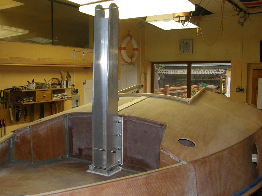

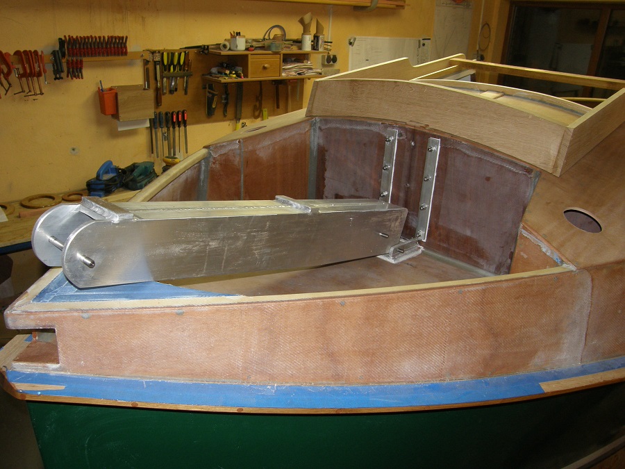

I welded the two Corner profile bars of 10 mm aluminum
