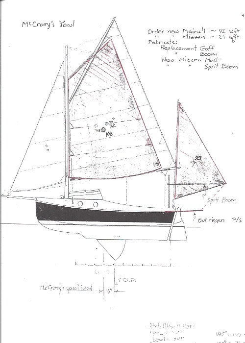

I like the new rig. From the diagram you can see that the mains'l is only 92 sqft (vs 109) and the mizzen is 27 sqft. The overall sail area is increased slightly to 158 sqft (vs 148). Mostly, I sail solo, and I find the smaller mains'l easier to handle. And I really like the way the mizzen adds stability. If the wind and waves are steady, I found that she could be steered with the mizzen sheet (hands off the tiller). But more practically, with a "tiller tamer" she could be set up to self-steer. Also, she could "heave to" without much trouble. Tattoo also sails quite well with just her jib and mizzen deployed. In a 10 knot wind (with that setup) she makes 3.5 to 4 knots easily.

Yawl sail plan overlaid on PocketShip's design sail plan . .

When at anchor -- the mizzen is deployed and sheeted to the centerline. It serves to dampen the extremes of PocketShip's tendency to "sail around" her anchor.
The mizzen sail is furled by rolling the leech about its sprit boom where both are held fast (to the mizzen mast) with a small bungee. There is a small halyard (1/8" diameter cord) used to raise the sail cover (a zippered sleeve). The mizzen mast is made from two pieces of Southern White Pine (laminated, tapered, and hollowed). Its weight is only 5.5 lbs. The total weight of the mizzen mast with sail and sprit boom (also Southern White Pine) is only 11.5 lbs. The boomkin is made of a single piece of ash, just 3.5 lbs. And the mizzen also serves as the sailing rig for Pluto (Tattoo's dinghy, an Eastport Nesting Pram) . Of course, the boomkin isn't needed for the dinghy. It's not as effective as its regular standing lug rig -- but quite useful in the harbor.
The mizzen mast was placed just to starboard of the foot well and its partner integrated with the transom coaming. Its step is bolted [and bedded] to the cockpit deck at the top edge of the "deck--foot well--transom" intersection. The boomkin is placed along the starboard side of the foot well extending aft thru a slot cut in the transom. The mizzen sheet passes thru a 3/8" hole in the transom and is reeved thru the center hole of a jam cleat placed just ahead of the inboard end of the boomkin within easy reach of the helmsman.
