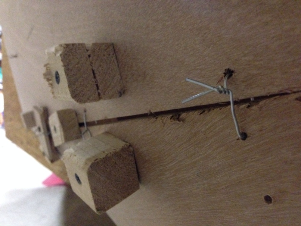

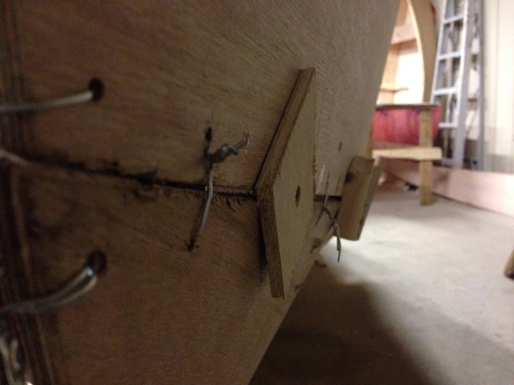

Here are two pictures of bow (port and starboard sides)
You can kinda see the gap: a little light is shining through. It's starting to look like swiss cheese up there with all the blocks and holes in the hull trying to pull everything into alignment. We're lucky the gap is identical between port and starboard!
Screwing a piece of wood with a backing plate right at the seam helped tremendously in bringing the two panels together. Before I was just clamping top-to-bottom, but that would force the top panel INSIDE the middle one. Adding the blocks right along the seam forced the two to stay in alignment. Really recommend that to other builders.

Yes, that gap looks almost exactly the same as mine. I would not be surprised to learn that we are not the only ones.

That's looking pretty good. That's how mine started, too, though I got mine a little closer eventually. Use 2 contraptions with their own clamps 3-4 inches apart to pull the gap together and then tighten the wires. Maybe you did, but I only see one? Use 3, or 4 if necessary.
You're going to spend quite a bit of time later filling and fairing so don't worry about how many holes you poke in the boat at this stage.

Wish I had thought of that! Small blocks attached above and below gap so you can use c-clamps to pull the panels together. Might need one every 4 to 6 inches along the gap.
One possibility is that the 1/4" screws on the alignment blocks could be holding the panels apart. I used a rat-tail rasp to make spaces for the screws. You have to be careful to be sure the screws stay aligned with the rasped-out spaces while you tighten them.
Will try the block-and-clamp idea soon.

Wow! That worked like a charm. Thanks truenorth and craig. If it wasn't for this forum I'm afraid my boat would be a complete disaster by now.
Anyway, I was able to pull the panels snug with a couple of sets of cleats and clamps on each side. The only problem now is that between the alignment blocks and clamping cleats I didn't have a heck of a lot of gluing area left (the cleats don't cover the seam but there is not enough room to get at it). What I'll do is wait for this glue to set up for a couple days, then remove the alignment blocks, leaving the clamps in place. Then I can glue the sections that were under the alignment blocks and that should hold.
