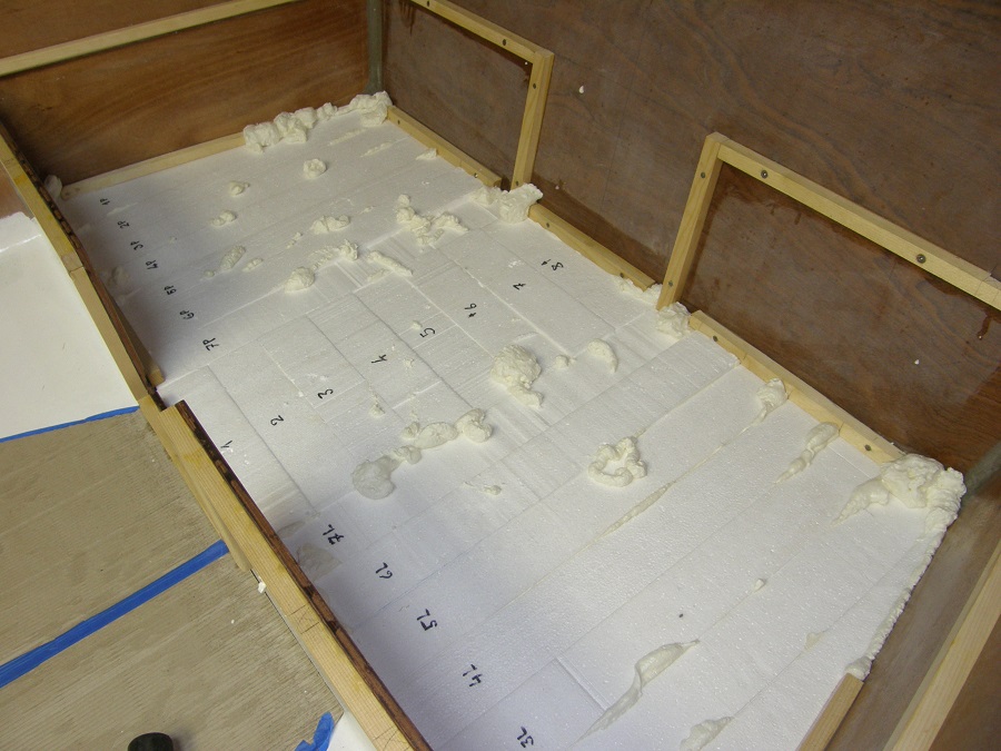

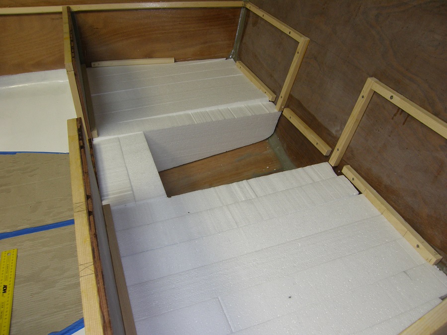

Postby truenorth on Tue Oct 14, 2014 5:19 pm
It's a miss in the manual. It's in the plans. If you look carefully at the plans, you can see the placement under the footwell. Also, other builders and bloggers have noted this, too (if you're not reading Dave Curtis' blog, I highly recommend it).
Here's my entry:
http://sunmonkeypocketship.blogspot.com ... twell.html
My styrofoam is actually 1.5" inches thick, which I found to be just the right size. If you use lazarette 'floors' which some people have, you can add more flotation back there. But the specs just call for it under the footwell.

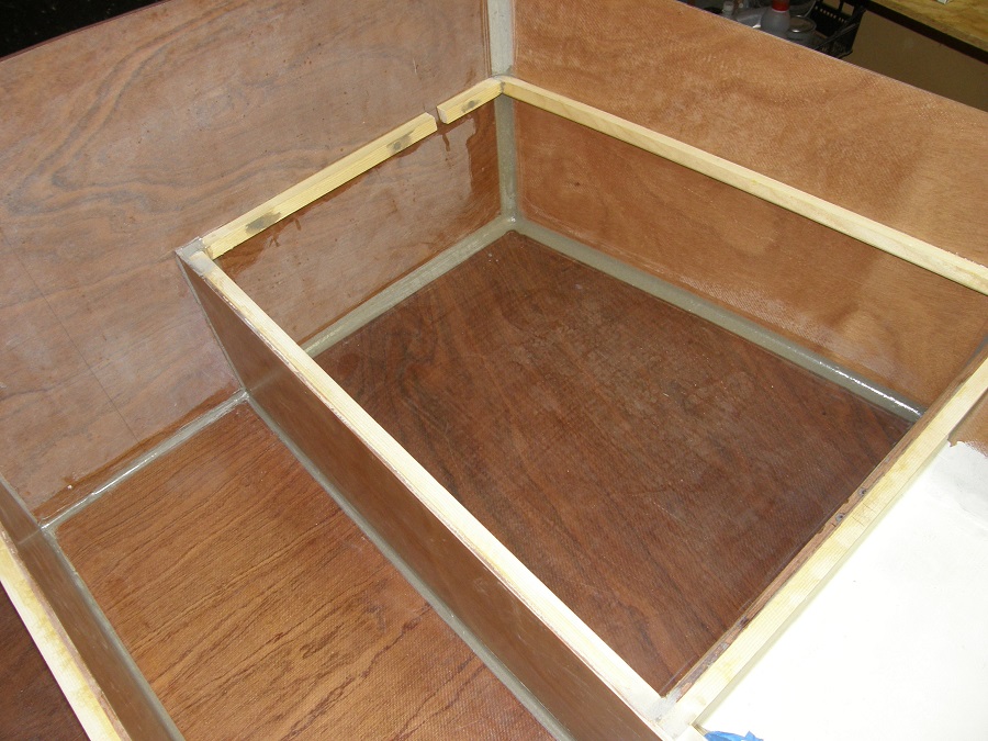

Re: Flotation Styrofoam: Transom Compartment???
Postby hood on Tue Oct 14, 2014 5:47 pm
I used polystyrene for facades
now without mounting foam
glued mounting foam
refinished

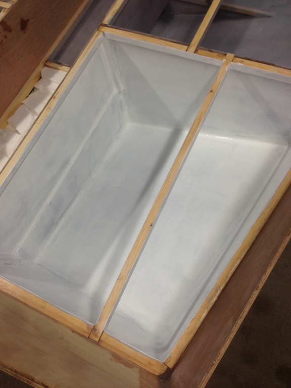

By the looks of those cleats I'm guessing that hood is planning to glass in plywood panels to seal off the foam from leaky hatches. What's more they could be made to drain into the footwell or even directly out through holes in the transom. Pretty clever.
Postby hood on Wed Oct 15, 2014 12:50 pm
yes water to drain through the holes into the legs and out through the transom
closed and sealed
Postby craig on Wed Oct 15, 2014 10:58 pm
I glued in a plywood plug to seal off the footwell underside from the lazarette compartment. Template easily made by cutting cardboard and tracing onto 4mm plywood. The sealed off compartment doesn't have a vent now, but I'm considering drilling a 1-inch hole and inserting a drain so I can air it out when on the trailer.

Many thanks for the advice and pics, Guys. I just heard back from John Harris/CLC on this issue and wanted to share it with you. John reviewed this thread on the Forum before he replied. Here's his feedback (paraphrased): '..he enthusiastically endorses the build up of the floors of the lazarette compartments so that they become self-draining; and the addition of the foam adds more safety. Downside is the lost volume in the lazarette lockers and the creation of an enclosed space not readily accessible for maintenance/ventilation. Suggests fiberglassings the compartments....'
Good luck
Postby John in CC on Mon Oct 20, 2014 10:54 pm
Thanks for the pictures! Nice examples of two ways of tackling the situation. Great timing, I am just at this point in my build...decision time. I am leaning towards the "maximum capacity" route. The flotation loss in this option is minimal. Also I really was proud of the fillets I did in the corners of the transome : )
