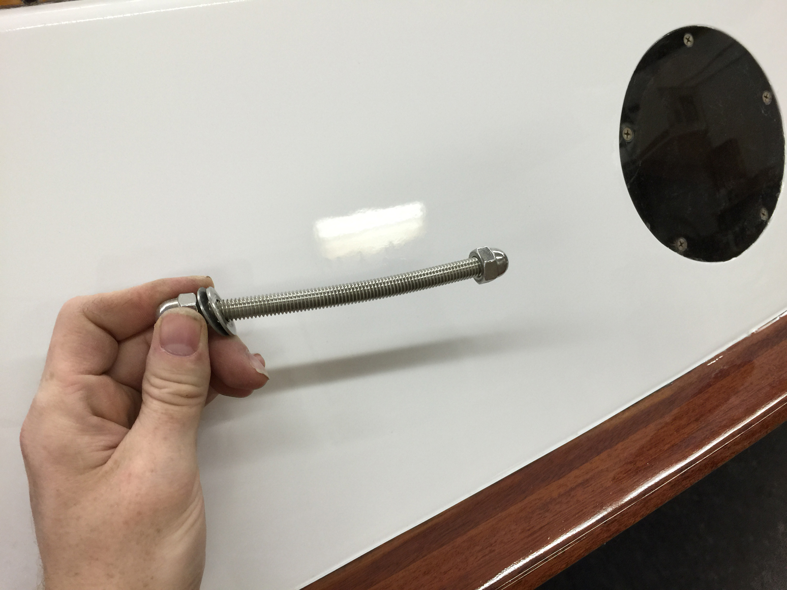

Tabernacle Pivot Bolt.jpg (892.72 KiB) Viewed 25077 times
I replaced and upgraded some of the rigging. One curiosity uncovered was that the pivot bolt in the mast tabernacle had acquired a significant bend! Since much of PocketShip's sailing loads get converted into mast compression, this is a testament to how much power the rig is producing. It's not easy to bend a well-supported 5/16" stainless bolt. Doesn't pose any danger to the assembly. I bent it straight again and reinstalled it.

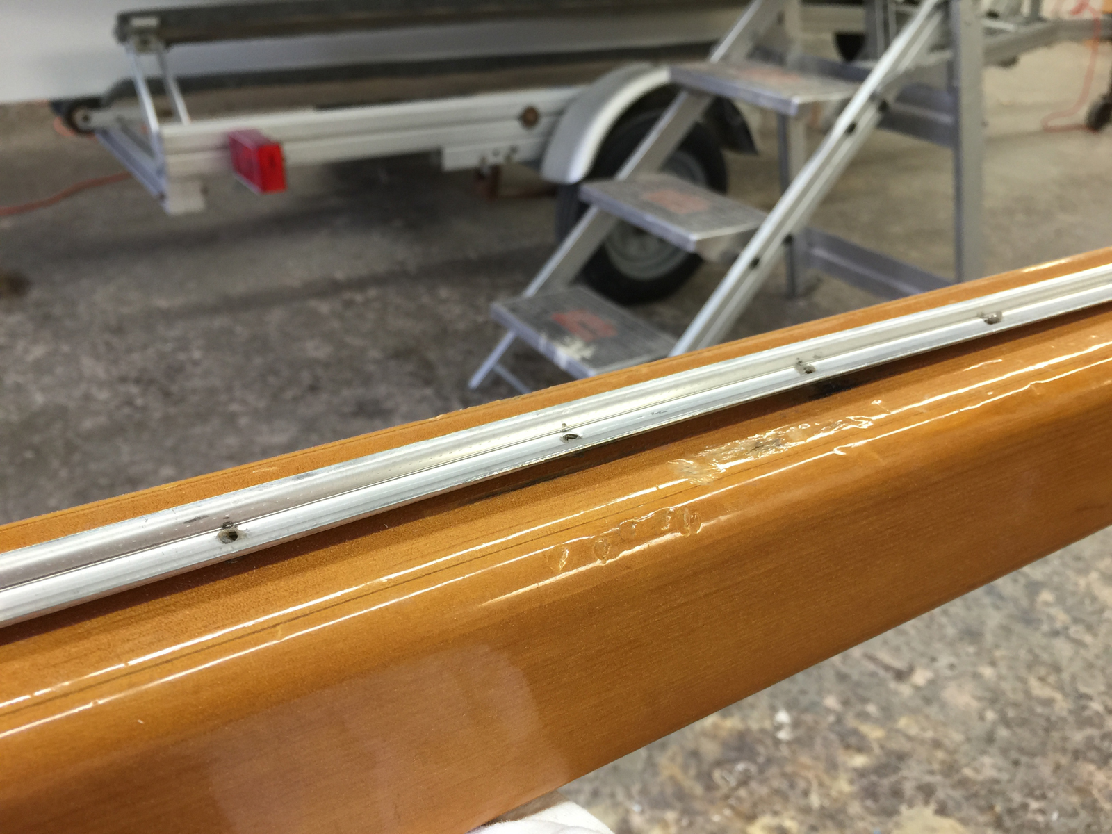

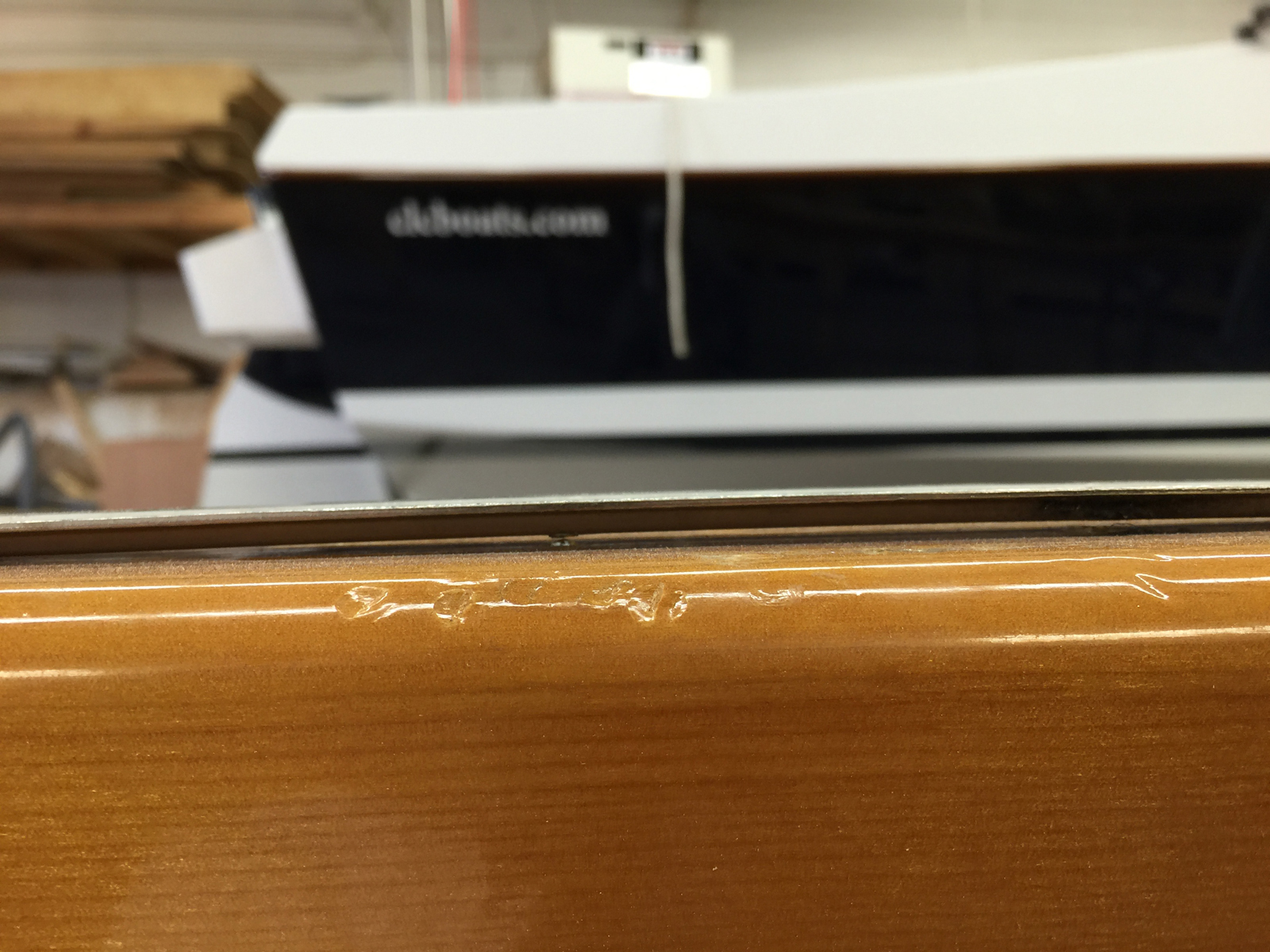

Broken Track 1.jpg (1.08 MiB) Viewed 25069 times
Broken Track 2.jpg (1 MiB) Viewed 25017 times
Another one to file under "This is a Powerful Sailboat." While I had the mast off, I inspected the sail track. At the point where the yard gooseneck sits when the mainsail is at full hoist, and also where it sits when reefed, the #6 stainless screws were sheered right off and the track was no longer fastened to the mast! Again, that takes some horsepower, though I note that PocketShip #1 has often been pushed to the limit in strong winds. I drilled fresh holes in the track, and doubled up the number of screws in the area where the yard pushes against the track at full hoist and when reefed.

I'm curious if anyone who has already sailed their boat hard has broken mast track screws like John noted happened on Pocketship No. 1.
Re: Notes From PocketShip #1's Refit in 2016
Postby John in CC on Mon Jun 26, 2017 12:21 pm
Bflat wrote:I'm curious if anyone who has already sailed their boat hard has broken mast track screws like John noted happened on Pocketship No. 1.
I had a couple of the track screws pull out last year. The main problem was that I used too short of screws. I took them all out and bought some thin penetrating epoxy and soaked each hole in the mast with it to reinforce the treads. Maybe not necessary but it did make me feel better when I replaced the screws with the proper ones. Also I drilled and doubled up on some holes and screws at the base of the track on the mast. I have had my pockeship out in some brutal conditions with no problems in the rigging.
