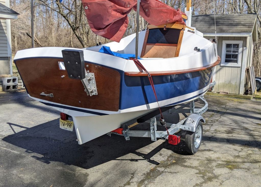

I got a very similar trailer: A dropped axle Load-Rite with 1500 lb capacity. I, too, had to build a keel trough and raise the side bunks. It took a bit of creativity and browsing Ebay and Amazon listings to find the necessary hardware.
Last fall I launched the boat a couple of times at a good ramp, and it was easier than I expected. The trailer's tongue is pretty long, which lets it get further into the water.
BTW, I highly recommend adding a step, like the one I attached in front of the left tail light. Without it, it is pretty hard to get into the boat without a ladder!
