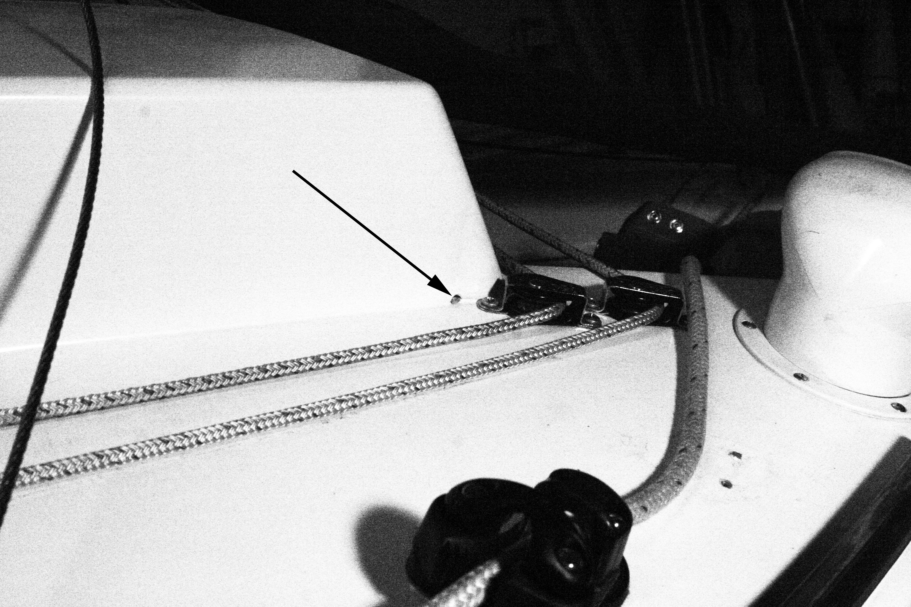

>>>>The drain holes in the companionway hood sides could be sized larger than the 1/4" stated in the manual
This has been a recurring issue with PocketShip #1, which lives outdoors about half of the year. The 1/4" drain holes at the front of the companionway hood get jammed with goo. Then the water backs up in there, sits stagnantly, and inevitably penetrates the companionway track assembly. The tracks then swell and obstruct the movement of the hatch. This happened maybe five years ago and was fixed, but cropped up again right before the WoodenBoat Show. It wasn't until I had the boat moored at the show that I noticed the hatch was really sticky. The hatch is currently in the shop being resealed with epoxy and touched up.
If the boat lives outside, poke a bit of wire in the drain holes once in awhile to make sure that pollen or tree debris hasn't clogged the drains. Making the drains larger, 3/8" or even 1/2", is probably a good tweak.
