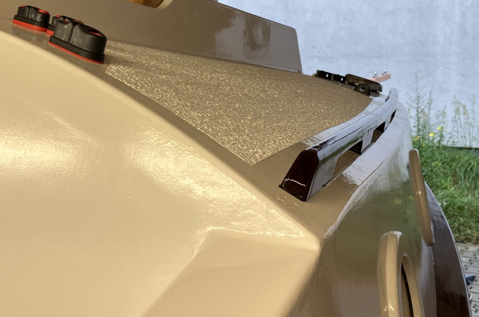

We'll be using Seadek for the cockpit. But for the cabin roof and anchor well we wanted s.th. more cost efficient and decided for KiwiGrip. One liter was more than enough for those areas. The application was straight forward, although the texture did not come out as nicely as I had hoped for.

Your last photo reminded me of something. On my boat, after a couple of seasons, the paint
just aft of the cam cleats (Interlux Brightsides) has gotten abraded away by the lines:
Fortunately the fiberglass cloth is doubled up on that area, but I wish there was something I could put there
to keep the lines from eventually sawing though the roof...

Thanks for pointing this out. I was considering a strip of clear protection foil for bicycle frames...

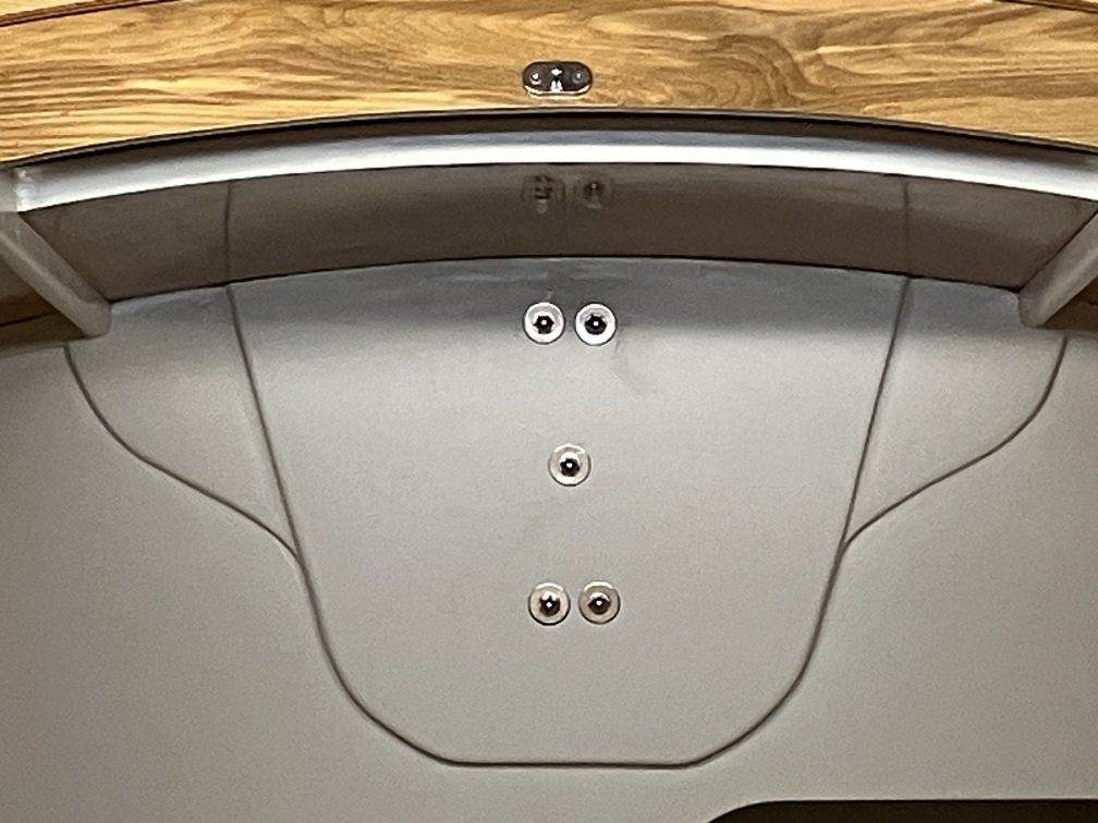

this week we finished the companionway and slide. There are three modifications.
- The drop boards are made of 8mm acrylic. The manual proposes 6mm thickness, but here only 5mm and 8mm seem to be available. We considered 5mm to thin and opted for 8mm.
- We mounted the hasp and staple upside down. My main concern with the original orientation is that my head will be in conflict with the piece hanging down from the slide.
- The endstop of the slide was implemented by a piece of 6mm plywood mounted onto the back of the slide, after the slide is inserted. The cleat at the front of the companionway opening serves as the actual stop. Taking the slide out for servicing just requires to loosen four screws.

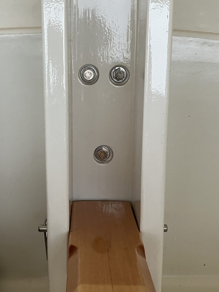

In May and June we basically worked on tabernacle, mast and spars. As usual, things take more time than expected :-) We mostly followed the manual quite closely.
We have chosen to build the tabernacle removable. The outside transition from cabin top to BH #2 received two extra layers of glass, and two pieces of 9mm of plywood have been glued to the inside of BH #2. The tabernacle itself has been strengthened by pieces of 6mm plywood glued to its sides. It is installed via five 8mm screws that are bolted through BH #2.
