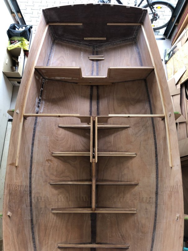

Bulkheads 4-8 are installed and all sections in between are filleted, glassed and sanded. This is a view from the attic.
Another view from the bow. You may realize that the cleats for later installation of the floorboards are still missing. This eased filleting, glassing and sanding. The cleats will be glued later. This photo also shows some temporary screws to push down the floorboards onto the cradle.

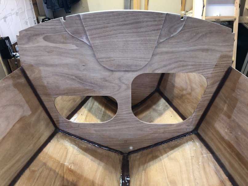

Next, we filleted and glassed the chine joining floor and side panels. Glass tape plus additional glass overlaps have been used at the chine to increase strength. The joints of all bulkheads with floor and/or side panels received additional strips of glass on top of the fillets (we were not sure if this is advocated by the manual, but it felt the right thing to do).
Whenever possible, glassing is done immediately onto the 'wet' fillets: First, we want to avoid the tedious job of sanding fillets. Secondly, we believe this method provides superior strength.
This shows the front part of our boat after glassing. As we plan for a removable tabernacle, bulkhead 2 has received two additional backing plates.

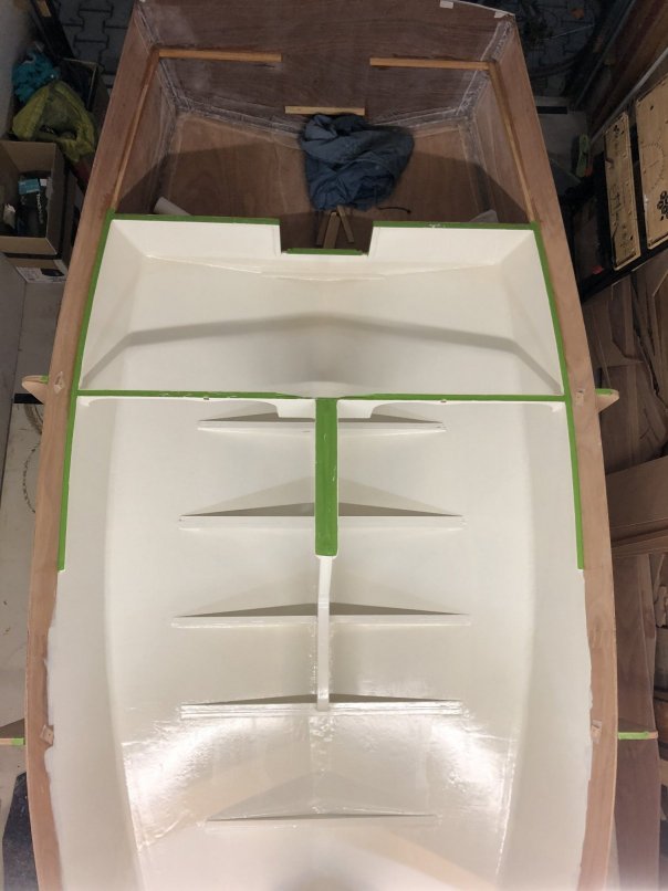

Everything got sanded and cleats installed to the bulkheads. There is additional cleating on bulkhead 4 and 6 as we plan for a different layout of the lift-out sections. We also started with cleats for the deck. You may realize the increased width of the cutout for the footwell at bulkhead 8 - we decided to copy this idea by Brent - https://idahopocketship.wordpress.com/2 ... r-braydon/ . The white patches close to bulkhead 8 are a first test to level out the transitions between glass sections by using epoxy thickened with micro spheres. This was done everywhere in between bulkheads 1 and 8.
The inside got painted with 2k PU color. Yes, it requires mixing two components but we did not bother after mixing quite a lot of epoxy during the past year. We hope 2k will be more durable. The painting was done prior fitting the floorboards; winter is coming and we are afraid it will be too cold for working with epoxy and paint soon.
