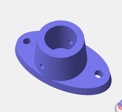

Postby [email protected] on Wed Oct 11, 2023 12:00 pm
My stern light was inspired by this setup: https://www.clcboats.com/media_gallery/ ... =2&next=23
It is actually a battery-operated light (which I have never had to actually use). I 3D printed a mounting base:
The lamp shines further forward than the regulations specify, but I doubt anybody would care. And it will work OK as an anchoring light.
My forward light is the same type, but with a split red/green lens, and it is mounted on the breast hook in a way that
allows it to shine in the correct direction.
I leave both lights in the cabin, until the need arises to use them.
