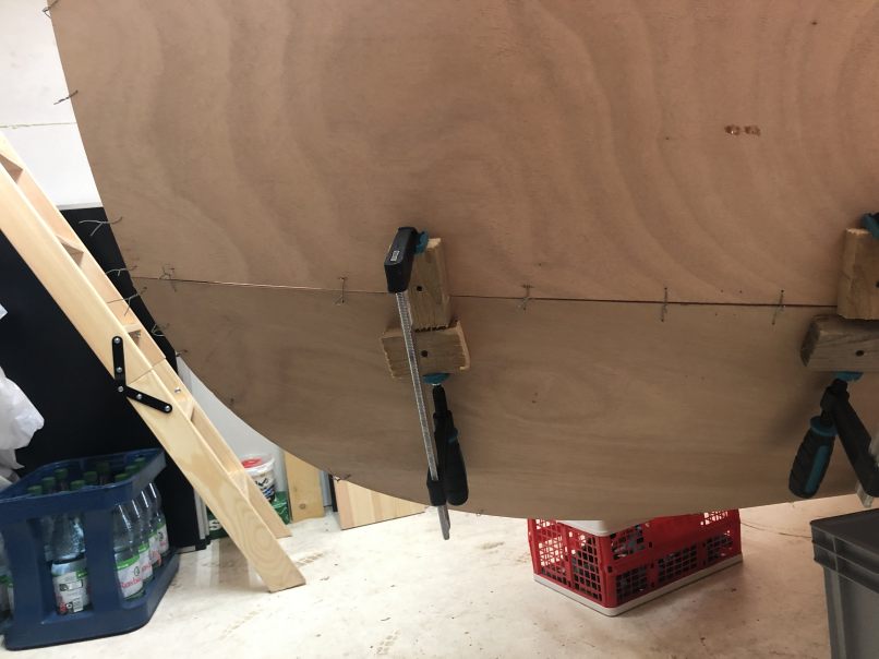

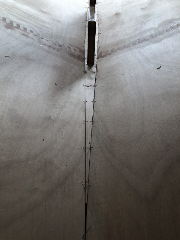

we had also completed the bilge area between buklheads #4..#8 prior mounting the side panels (see here) and I think it was a good idea.
We had a gap of a few millimeters around the forward end of the keelson but not between bottom and side panels (see photos).
The only issue we had was a gap between bottom and side panels in the area forward of bulkhead #1. At that time I had seen posts of a few other builders with the same issue. One of them used c-clamps to force the panels together; we used that trick too.
When stitching side and bottom panels together, we made sure bottom and side panels aligned well with the cradle by using one c-clamp and on screw per side. Moreover we had used wood piece as a spreader to push the tops of the side panels to the outside at the bow using a c-clamp (see photo). Later, the top edges of the side panels are supposed to meet at an angle of about 90 degree at the bow. Take the lower breast hook contained in your kit as a pattern and also do a trial fit of bulkhead #1 to get an idea how the final shape of the side panels will look like. I could imagine bending the top part of the side panels has an influence on the gap you see at the bottom.
