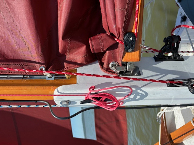

Here’s a picture showing some of the upgrades:
The small red lines are the lazy jacks. The curled hooks on the boom with nothing in them are used to stow the lazy jacks when I lower the mast or just don’t want them up. The first reef is in. You can see my track slide extension. Oh and the masthead cable I was trying to figure out a month or so ago.
