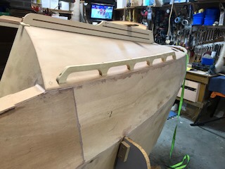

Postby Hooky on Tue Aug 06, 2024 10:24 pm
Rather than a toe rail I decided to add grab rails to the cabin top. I think grab rails will provide additional hand holds, somewhere to tie off fenders and look good. I built the rail from Hoop Pine and will laminate a strip of blue gum on top after the final install. To ensure the smooth curve I steamed the rails and bent them on a jig.
For a detailed description of the build and pics check out the Blog.

G’Day Dietrich,
Thanks for the info mate, especially as my rails sit above and are screwed into the sheer clamps. I did consider this when installing the rail by laying a ruler against the hull side where the chain plates sits and it looks like it will just miss the rail. plus I cut the rail feet at the same angle of the cabin top so they sit very upright however if it fouls then I may have to install timber shims under the chain plates, I guess I won’t know until I install the mast.
Cheers
Terry

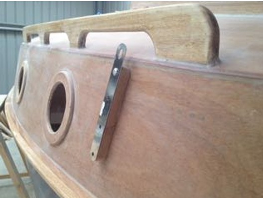

Hi Steve, good point thanks mate, If the shackle fouls on the grab rail I'll consider a timber shim (similar to Kermadec, I hope Rob doesn't mind me using his boat pic as an example) I think I can make it a nice chain plate feature as well.
Cheers
Terry
