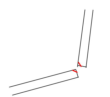

Sometimes its an issue that both panels join with a edge. When wiring together, one panel might 'snap' over the other one. We had relaxed the situation by taking away the top of the edge with a plane. Just a little bit as indicated by the red lines on the attached (lousy) drawing. This helped a lot especially at the joint between floor and side panels.
