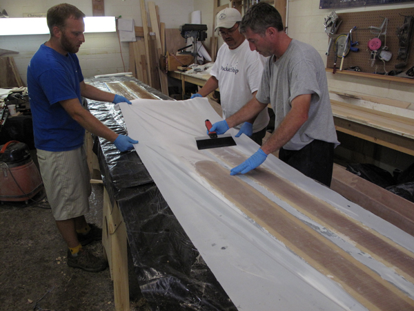

I've done all of the pre-'glassing on the Madness Proa with peel ply. A 31-foot multihull has lots and lots and lots and lots of 'glassed surface area. Being able to do the 'glass in one shot, ready for 220-grit sanding, is amazing. I need to do a proper comparison but I think you tend to save weight when you use peel ply, too.
Peel ply: http://www.clcboats.com/shop/products/b ... abric.html
Peel ply being laid onto 26-ounce unidirectional glass on crossbeam components for the proa. A wide squeegee was helpful for smoothing out the peel ply.
Peel Ply Example.jpg (237.05 KiB) Viewed 22913 times
