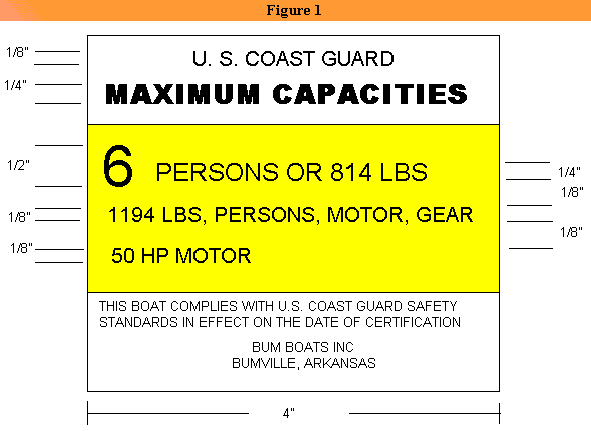

Does anyone know what the Coast Guard requirements are for labeling on a Pocketship? The regulations say they apply to anything under 20 feet except kayaks, sailboats, and inflatables but don't say how to lable the exceptions. Any thoughts?

It is my understanding: given an example capacity label like
For recreational boats 19 feet 11 inches or less, sailboats or other boats not covered by the requirement just delete the words US Coast Guard at the top of the label and delete the certification statement at the bottom of the label.
