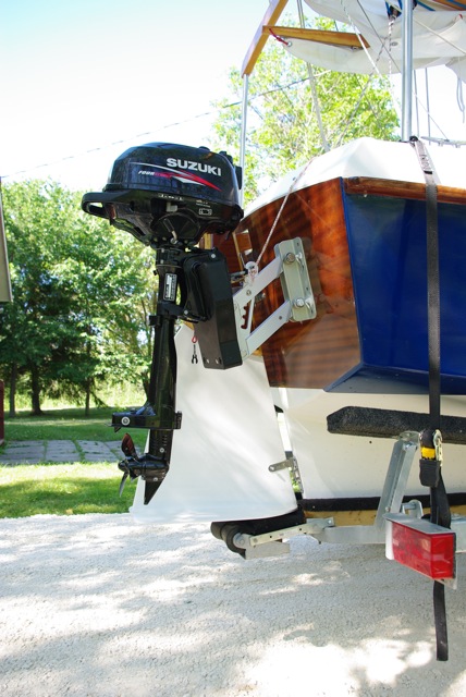

I finally got to test out my new 2.5HP Suzuki outboard and motor mount on our first sail of the year. Even though I was restricted to 1/2 throttle due to the break-in period the power, torque, and control was far superior to my electric trolling motor experiment. The photos show the motor in its up and down position when trailered and while on the water. When in the down position the cavitation plate is a good 4 or 5 inches below the waterline. I think this small motor and bracket is probably as unobtrusive as you can get for hanging an outboard off the back of Pocketship's fine looking transom.
Up position
Down position

I forgot that I had a question about using a motor bracket like this one. The manufacturer says the motor should be removed for trailering but for my short trip of 2 km to the boat launch it is a bit of a hassle draining the carburetor etc. This outboard only weighs 30 lbs so I was wondering if anyone has experience trailering leaving the outboard on the bracket?
I also forgot to mention that the bracket installation was fairly straightforward but you do have to check where the holes will be drilled. My top holes are inside the transom and cockpit (visible in the photos with a backing plate I still need to shape and finish) but the bottom holes are accessible in the lazarette.

Pete M, another Pocketship builder contacted Garelick, the bracket manufacturer, and they couldn't provide any actual technical data on trailering with the motor attached. It would appear that the company is being cautious out of fear of being sued rather than any engineering analysis. I trailered with mine on the weekend and it was fine and Pete has trailered with his 59 lb 6 HP without a problem. Of course, as Pete points out you should trailer with a safety tether hooked to the boat hull just as you do when you are on the water.
