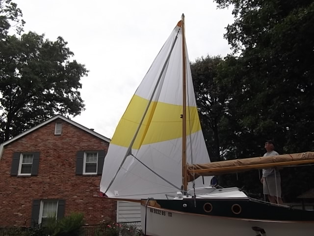

I finally rigged Tattoo for use of the spinnaker. Henry (my sailing friend) and I first setup the rig in the driveway for a "dry" run. All went well. So we took her on the water for "sea trials" in winds only 5 to 10 knots. Mostly, we had no wind at all. But there was enough to test our jibing skills. We deployed on a port tack, jibed once, and back to a port tack for recovery.

Deployed on port tack.
