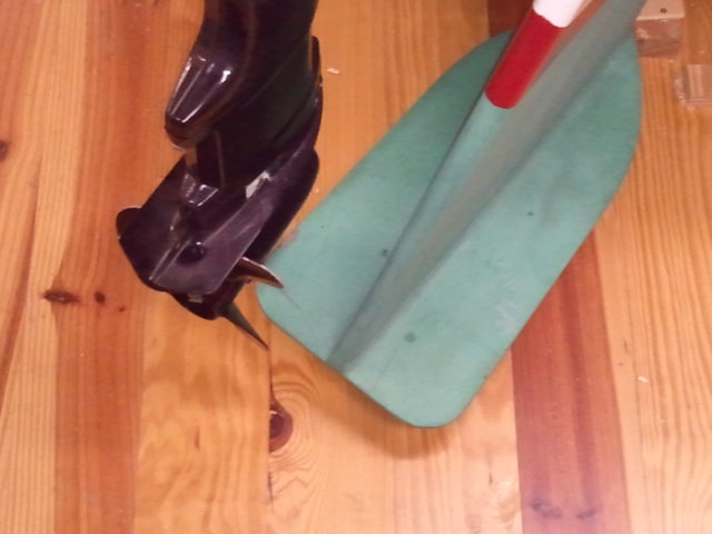

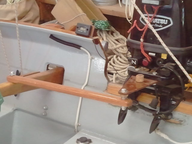

But maneuvering at slow speed was problematical, especially to port. The engine produced an asymentical thrust (to starboard) and the rudder has little effect at slow speed. So, I've installed an engine-to-tiller linkage. I had my doubts as to wheather it would be too unwieldy. But I think it will work just fine. Now the thrust line of the engine is always near paralled to the rudder and there need not be any limitation on the swing of the triller. The photos show the limits of rudder deflection. Maneuvering at the dock and into and out of slips will be much easier.
The mahogany linkage shaft is easily removed by unscrewing two "acorn" nuts. The nuts are stowed back on the 5/16" bolts and the linkage shaft is stowed in one of the cockpit side pockets. When the linkage shaft is removed the the starboard lazarette hatch my be opened by rotating the engine shaft so that the linkage arm is out of the way. The hatch may be opened with linkage in place, but the tiller has to be put hard to starboard.
In the garage it seems to work quite well. With the prop thrust line parallel to the rudder and the prop freewheeling, maybe the drag will be insignificant. Sea trials will tell.
Tiller-to-engine linkage

Rudder to starboard, limit
To stbd.jpg (65.23 KiB) Viewed 9728 times
Rudder to port, limit
To port.jpg (49.92 KiB) Viewed 9751 times
