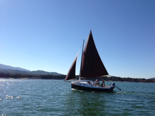

Postby sean on Thu Oct 18, 2012 12:36 am
Another Pocketship is finished! We launched 'Garage Sail' last Saturday at Cachuma Lake here is southern California. A beautiful day with light winds. Will be ready for more wind next time, but was perfect for a new boat and a rusty sailer.
Check out more photos at: http://buildingpocketship.wordpress.com ... /index.php
