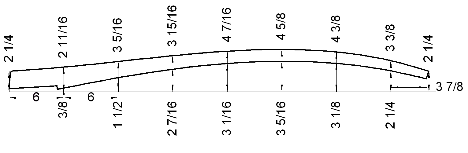

My dad has been building a pocketship, so I thought that for Christmas that I would laminate a tiller for him with two different coloured woods. Could some let me know the dimensions? Is it safe to use most woods, as long as they are well varnished? I could ask my dad these questions, but it would be less of a surprise.

Postby John C. Harris on Mon Nov 26, 2012 2:19 pm
I have an emailable version; john [at] clcboats.com
Or let's see if I can post it:
Tiller Dimensions.jpg (153.59 KiB) Viewed 36031 times

Thanks, John. Maybe I'm missing something, but I couldn't figure out the thickness.

Postby JonLee on Mon Nov 26, 2012 4:45 pm
The tiller should be 3/4" thick. I'd go with at least one strong, fairly stiff wood in your laminate...at 3/4" thick, the tiller can be a bit floppy under load if you use a wood that is not stiff enough. I sailed PocketShip #1 and found her 3/4" tiller to be a bit too compliant for my tastes.
My tiller is made out of solid 1" thick ash, milled to 3/4" where just where it slips into the rudder. It doesn't deform under load, but of course it isn't as attractive as the laminated tiller you are hoping to build. :-)

Pascal, that is exactly what I had envisioned doing! Very helpful pictures on your blog. How thick did you decide to do each strip? Would you advise that I do an extension from the start? Did you simply do ten 1/4" strips that were an inch wide?

I would recommend doing the extension at the same time. While sitting back you cannot use the tiller very well. With the extension it is very comfortable. I did use 1/4 " strips ;) and I took the cut off part to do the extension. I could send you a picture to an email if you like.

My original tiller was longer and thicker-sectioned, stepping down to 3/4" where it slotted into the rudder. This "felt" right, but I drew the hole in the transom too small on PocketShip #1. The thicker tiller bound in the opening, limiting the swing of the rudder. Also, that tiller extended nearly to the front end of the cockpit, great for singlehanding but a nuisance with a crew aboard. I replaced it with the shorter laminated tiller in the plans and manual.
