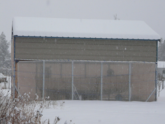

I live in Montana with similar weather extremes. I bought a heavy-duty metal carport to keep everything snug and dry while building as well as where the boat will live when it's finished. It has UV-protective tarps on the east and south sides, a set of metal doors facing west to handle the storms that come barreling through here and also where the boat will come and go on the trailer later on. There's a clear tarp facing north where UV isn't much of an issue and I can see the boat in progress and look forward to spring. I'm careful not to expose the epoxy to temperature extremes, so all of that is put away for the winter in my insulated garage. My project is taking a long time since my boat-building season is pretty short and also takes place while I want to be kayaking and doing everything else, but oh well. It'll get done eventually!
