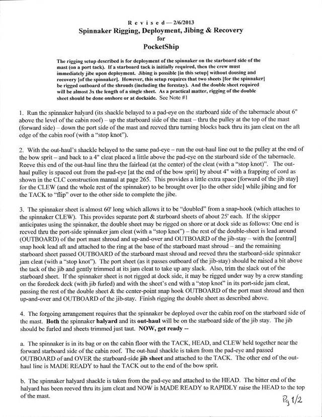

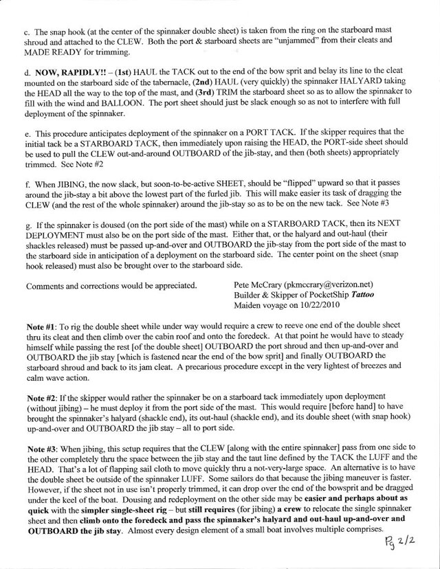

Dave & John, ... Although I plan to use John’s less complicated single-sheet rigging setup for spinnaker deployment on Tattoo – some skippers my want to rig their PocketShip so that jibing may be possible without dousing the spinnaker. To that end I have corrected and revised my description of the rigging procedure for the double-sheet setup. The two pages are attached here in “.jpg” format. I think they can be printed by “right clicking” on the images. If members want a “.pdf” version -– just request a copy (to my email address).
Page 1, Double-Sheet Spinnaker Rigging Setup.
Spinnaker r1 pg1.jpg (200.62 KiB) Viewed 31747 times
Page 2, Double-Sheet Spinnaker Rigging Setup.
Spinnaker r1 pg2a.jpg (200.4 KiB) Viewed 31690 times
