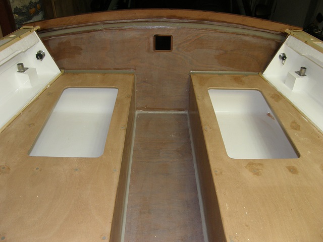

Postby hood on Tue Jun 10, 2014 10:11 pm
connector for charging and taillight
Re: wire route to transom
Postby hood on Tue Jun 10, 2014 10:22 pm
Shrouded connectors from water
Postby truenorth on Tue Jun 10, 2014 11:33 pm
Hood isn't messing around. That is a high quality electronic thru-hull. Which brings me to the point... boats have thru-hulls everywhere, some below the waterline. If done well with the right equipment, they are safe and last for years. The key is to do all the little things that must be done to ensure a watertight fit, and when it fails (I'm not that naive) be sure there's access enough to fix it. I like that Hood left the rear "temporary" form in place. It makes for an elegant solution. I just finished sizing the seatbacks and after seeing this I'm tempted to use it.
I'll add, though, that there's something to be said for simplicity. A battery powered LED will last a long time, and it's certainly much less headache.
Postby DanaDCole on Wed Jun 11, 2014 10:48 am
Looks good alright. That appears to be a Seachoice 10161 connector. Correct?
I didn't see anything about the B8 thru-hull though. Your point is well taken, Truenorth, that the thru-hull should be accessible when it fails. I think that trumps putting it below the floorboards. A little wire or conduit showing back there is less important than access. And it would be smart to get it above the waterline.
Looking at Hood's pictures, it appears that the connector is mounted with screws through a flange base. If those are wood screws, not bolts, then it should be easy enough to remove the screws, pull out the connector, and re-seal it, repair the connections, or whatever is needed. Obviously the flange should be on the forward side of the bulkhead to be accessible from inside the cuddy. If I put it a foot or two above the waterline I probably will not have any failure problems.
