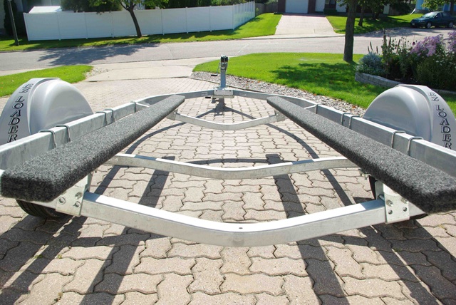

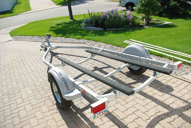

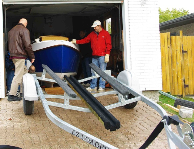

Here are some photos of the EZ Loader trailer that I modified. It had a slight drop axle but still not enough for Pocketship to fit in a standard garage. I bought a portable garage with a tall door to store my Pocketship at the cottage. When it is assembled I will post pictures on my blog. The third photo shows the keel trough I made from pressure treated lumber. You can also see that I added taller brackets to raise the height of the bunks. There is also a roller attached at the rear of the keel trough. The cost of the trailer was approximately $1500. All my boat information is at the cottage so I will post the model number of the trailer at a later date.
Re: Trailer for Pocketship
Postby decurtis on Thu Jul 22, 2010 2:03 pm
The trailer model I used is the EZLoader EZL80 15-16' rated for 2000 lbs. This is a bit of overkill for the 800 lb Pocketship but this was the model that best accommodated the length and width of Pocketship. As I mentioned previously this model also came with a bit of a drop axle.
