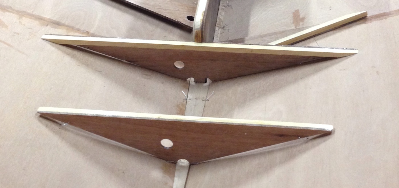

After stitching together the hull, the bottom portions of bulkhead 1 & 2, and of floor 3, were significantly higher than the bilge panel despite properly aligning the hull, making sure the sides of the bulkheads were touching the middle panels, and tightening the stitches as much as possible. Picture: floor 3 and floor 4

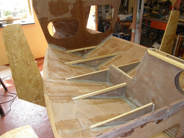

Beautiful work. Interesting that you put in bulkheads one and two and did some fiberglass reinforcing on floors before adding side panels. This seems like a pretty good idea because you can do a lot of the important filleting, especially near the bow, without standing on your head and reaching so far. I think this allows you to do a better job of it.
I assume you will add another layer of fiberglass over what you have there now when you add the side panels?
I also wish I had seen this earlier and learned about the various methods you used to get the alignment correct. I doubt mine will end up anywhere near as close, although the measurements I have taken look pretty fair--off maybe 1/4" over the entire length of the boat. Anyway, I don't plan on racing it. I remember when I sailed with Captain Charlie on Yepimadeit he didn't even bother to lift the motor out of the water because we were just messing about in her. I think that prop added significant drag, yet we easily achieved hull speed according to my GPS. The wind was probably around 12-15 knots. So I'm not all that worried about slight misalignment--still, if I'd seen and used your methods it would probably be closer to perfect and that can't be a bad thing. Besides better performance, good alignment helps all the subsequent parts come together properly.
