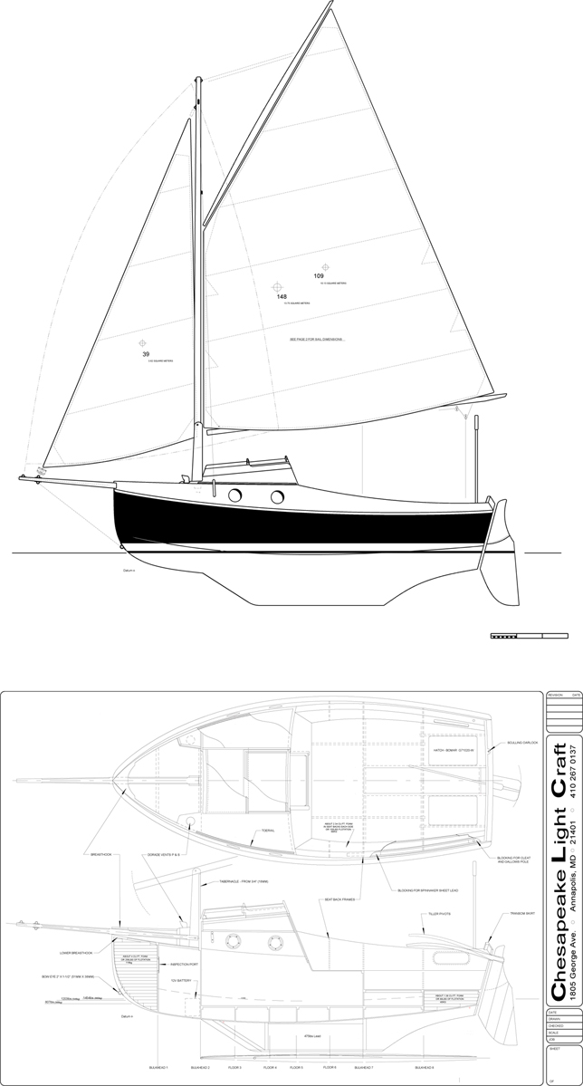

I note the hand-wringing over the centerboard in the threads here, but really, everything's a tradeoff. PocketShip's installation is the most forgiving I've seen in boats of this type. Maybe I should revisit a fixed keel option for PocketShip...
Fixed Keel PocketShip - II - Thumb.jpg (210.6 KiB) Viewed 28985 times

I like the keel version. Clears up the cabin for all sorts of fun. Maybe just me, but looks a little 'paunchy' in front. If given the choice, I would've gone that route.

The keel version might be a good seller. Not for the likes of me, though. I sail in small lakes and reservoirs and need easy trailering and shallow launching. If I ever move near the ocean or a Great Lake I might want one though.
