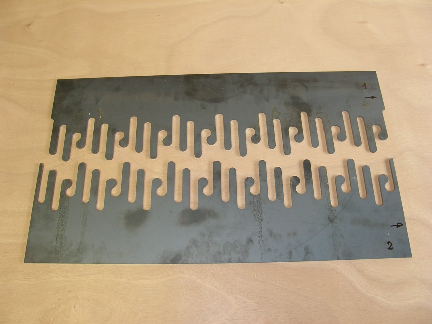

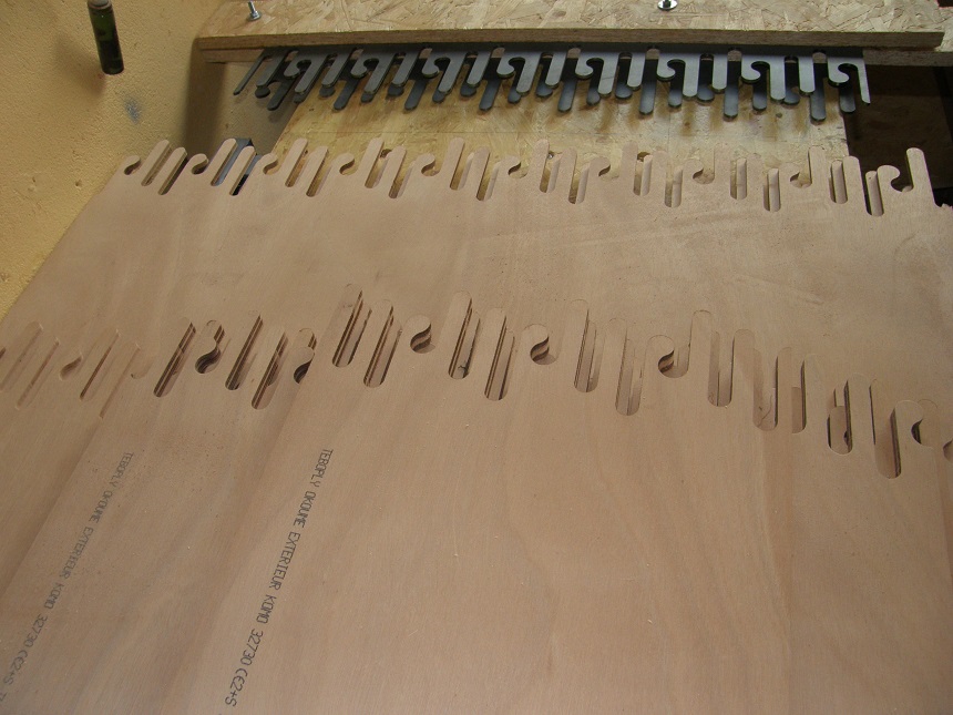

the template for milling the fingers on the connection plywo
Postby hood on Fri Jul 11, 2014 4:36 pm
the template for milling the fingers on the connection plywoods
Re: the template for milling the fingers on the connection plywo
Postby craig on Fri Jul 11, 2014 6:33 pm
Did you make that or buy it? If bought, where from? Dana posted a link a while back but the website never worked. This would make scarf joints MUCH easier to do. The Pocketship manual says they are not as scary as their reputation, but so far it was the most challenging part of the build for me. I would love one of these...
Postby hood on Fri Jul 11, 2014 11:41 pm
the template is excised by laser from sheet steel 4 mm. the fingers are 15 mm wide
Postby DanaDCole on Wed Jul 16, 2014 11:54 am
Well if you made those things I'll bet you could make more and sell them to boat builders (and not just PocketShip builders).
