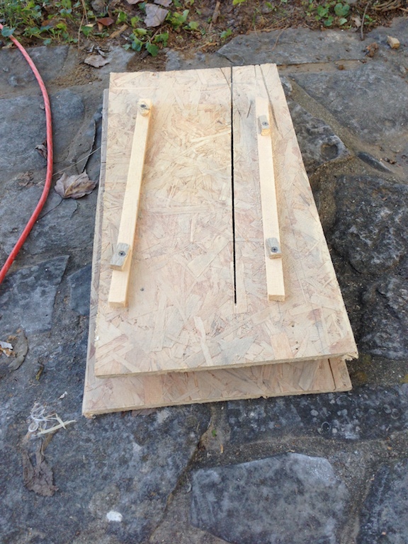

Lumber scarf joint circular saw jig

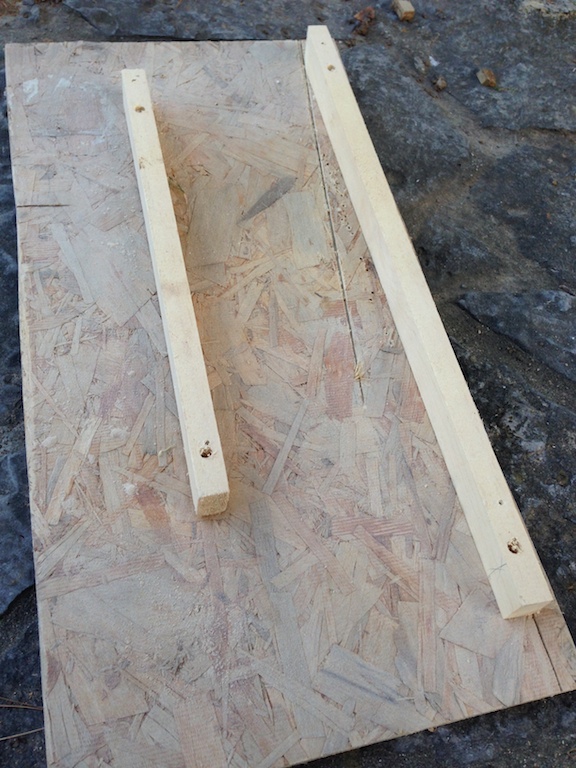

This jig will cut a beautiful scarf joint (say, for the rub rails) with a circular saw. Screw down two strips of wood (maybe 1.5inch high by 12inches long) parallel to each other in a plywood base. Then, screw a second piece of plywood on top of the lumber strips. This forms an enclosed channel where you will insert the wood to be cut, which will be placed firmly against the right-side lumber. You can either screw the wood into the plywood base, or use wedges placed next to the lumber to hold it in place.
On the top piece of plywood, screw or glue in two strips of lumber that will act as guides for your circular saw. The saw will run tightly within this channel, cutting a perfectly straight line. The angle of your channel (and hence, the angle of your cut) will be determined by your scarf joint size. For scarfing pieces of lumber as we are doing here, you probably want 1:10. So, measure back 10” from the end of the right-side lower piece of lumber, then 1” out from that. This makes a right triangle of base 10 and height 1. Connect the ends to form a triangle, and align your channel so that the saw blade cuts directly on that line (the blade kerf should be to the LEFT of the line, since we want to keep everything to the right of the blade). Screw down the channels securely.
Make sure you set your blade depth to not cut deep into the plywood base.

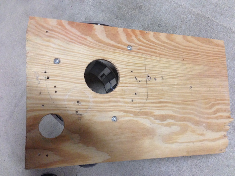

First, you will replace your router’s plastic base with a new one made from plywood. Cut a length of plywood approximately the width of your router base and a foot long. Unscrew the plastic base from your router and place it at one end of the plywood. Carefully mark where the screw holes are, and drill out with a thin drill bit. Use a wider drill bit to countersink these screws so they will not protrude from the plywood (you want the base of the router to be flat across, not bumpy with exposed screws). Make sure to not drill completely through the plywood. Also cut out the middle circle for the router bit. Screw the new base onto your router.
The jig will cut a circle by revolving around a pivot point. For the portholes, I cut a circle of 6” diameter, or 3” radius. Measure 3” from the edge of the router bit and drill a hole in the plywood base at that location. You can see all the holes I’ve drilled in my jig. My router was too wide, so I drilled through the plywood into the router base where there was a void in the metal frame; the screw could only go in half an inch, but that’s all you need. Then, drill a hole in the wood you want to cut a circle out of. Remove the drill bit from your drill and push it through the finish piece of wood and through the router jig. The router should then pivot around that location. When cutting, the router should remove material from OUTSIDE the circle, so the finished piece is the diameter that you want.

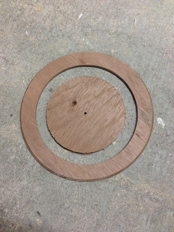

Your finished piece will have the pivot point hole in the center, so I cut a template from 1/2 inch plywood and used a flush-trim router bit to cut out the acrylic porthole widows. To cut out the porthole flanges, I first cut out a circle of diameter 6inches (porthole size) plus .5inches flange on each side, for 7 inches total. The inside of the flange should be .5 inches into the window, or 5-inches diameter (these measurements are examples only. I can’t remember what I used. Look at the plans for the official dimensions). I measured on my router jig 2.5 inches from the OPPOSITE side of the router bit and drilled a hole in the router jig at that spot. You are measuring to the opposite side of the bit, because this time you want to remove material to the INSIDE of the circle, not the outside (you want to keep the outside material, because that is your flange!) Use a screw to temporarily anchor the inside of the circle so the whole thing doesn’t rotate as you spin the router. In the end you will have a small waste circle in the inside and a beautiful flange on the outside.

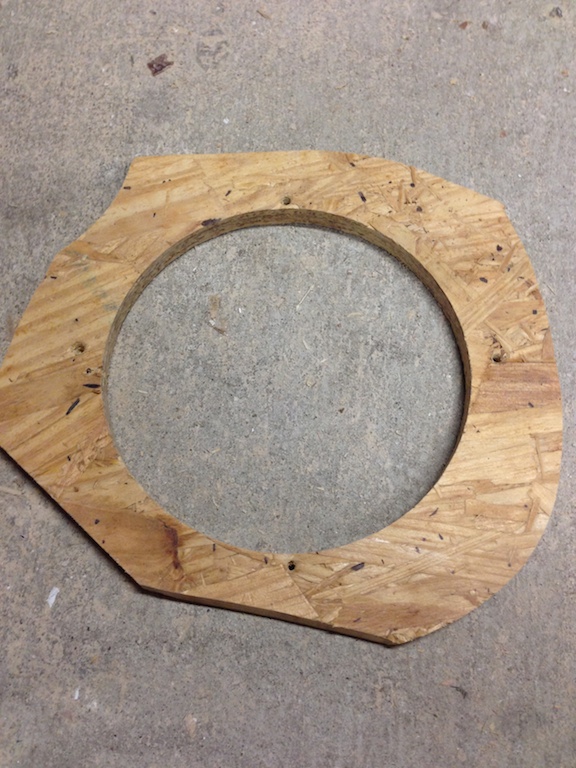

To cut out the porthole openings, I made a “reverse template” from scrap OSB. The hole should be a shade larger than 6” to fit the acrylic I cut, so I again measured from the OPPOSITE side of the router bit 3”, and cut out the circle. The resulting hole was perfectly sized to fit my acrylic window. This was then screwed onto the side of the boat and a flush-trim router bit used to cut out a perfect circle from the inside.

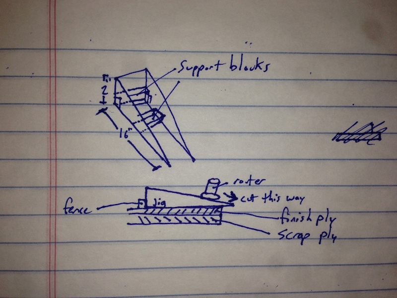

The idea is to build an angled track that the router will rest on. As you move the router, the bit will gradually cut through the wood at an angle, forming that perfect triangular taper.
The jig consists of two triangular pieces of wood cut to the appropriate angle depending on your scarf joint. For joining plywood, this is probably 8:1. So, measure some scrap plywood 16” (or more) wide, and 2” (or more) high at a right angle. Connect the lines and cut out your triangle. Now make a duplicate. Use blocks of wood to connect these triangles at the high end so that they are held maybe 5” apart or so. Base this distance on your router size: you want the router to be able to move a bit left-or-right in the channel, but not ever fall off either support. Narrower is better than wider. Make sure to not use any supports near the sharp pointy end of the triangle, since that is where the router will be cutting.
Measure 2” back from the edge of your plywood and draw a straight line across. This will be the start of your scarf joint. Place the triangle jig on the wood so the pointy ends are hanging off the edge maybe an inch or two. Put the router on the incline and make sure that the router bit can lower enough to extend so that it will cut through all the plywood. Then, securely clamp a straight piece of wood to the plywood to act as a rear fence for your triangle jig. This will keep the jig in the correct orientation and prevent it from sliding backwards, which would ruin the calibration with your router bit depth. Make sure this fence is parallel to the edge of the plywood.
Press the triangle jig firmly against this fence and place a heavy weight on the rear part to hold it down. I used lead blocks. Then, place the router on the jig and lower the bit so that the tip of the bit just touches the plywood where the pencil line is marking the start of your joint. Since the incline of the jig is 8:1, the router bit will then exit the wood at the very end of the piece. Setting the bit deep enough is very important, especially if you are stacking multiple pieces of ply. Your bit needs to cut completely through one piece of ply. If you are not deep enough, your scarf length will not be 8:1, thus weakening your structure. OPTIONAL: If you want, you could raise your bit slightly so that you leave one ply or a half ply of wood at the end of the plywood. This will prevent tear-out of the plywood and give you a nicer edge in case you are varnishing the boat. I was painting, so just filled the tear-out with thickened epoxy, but the joint IS ugly. Keep that in mind. If you leave a thin edge, you must go back over the joint with a block plane or sander to remove the extra material - make sure to remove the same amount of material from across the entire joint so that the incline is consistent and not curved. Curved would be bad.
Now that your router bit is set to the correct depth and the jig is held securely in place, turn on the router and carefully pull it down the incline. Move the router back to the top and repeat. Do this until you get close to the edge of your jig, then move the jig over and continue. This will take a while. The edges are especially tricky since one of the jig sides won’t have anything to rest on. In that case, just do the best you can and gently lift the router up so it isn’t pressing down hard on the jig.
