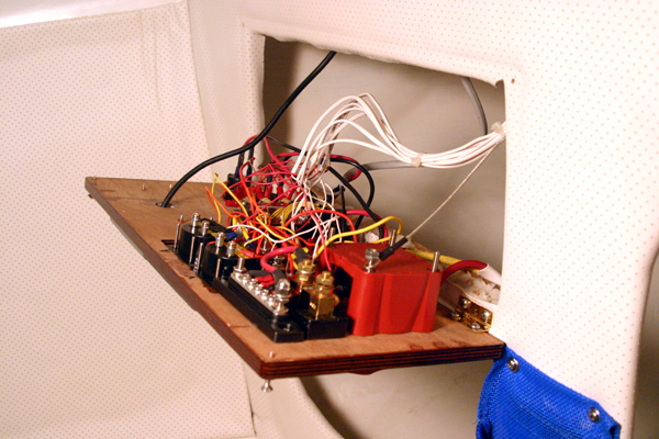

The panel is hinged at the bottom, so I remove two screws to access the back of the panel.
Back of Switch Board.jpg (299.56 KiB) Viewed 59075 times

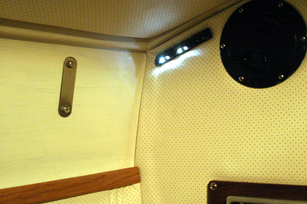

For interior lights, I found some inexpensive LEDs, which I mounted on the upper left and right sides. They aren't especially bright, but the power draw is maybe half an amp or less.
White Interior Lights.jpg (326.7 KiB) Viewed 59614 times

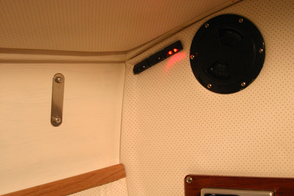

I put a set of red LED lights on a separate switch. A bit posh, but honestly I've done a lot of night sailing, and it's great to be able to duck down into the cuddy to find a sweater without ruining your night vision. My Folkboat had this feature and it was great.
Red Interior Lights.jpg (253.38 KiB) Viewed 59120 times

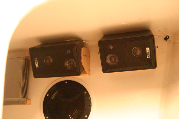

The front speakers (KLH's from Radio Shack---excellent sound and very durable, even in the damp) are mounted in the forward storage compartment. The amp for the stereo is on the left.
Forward Speakers.jpg (205.38 KiB) Viewed 59170 times

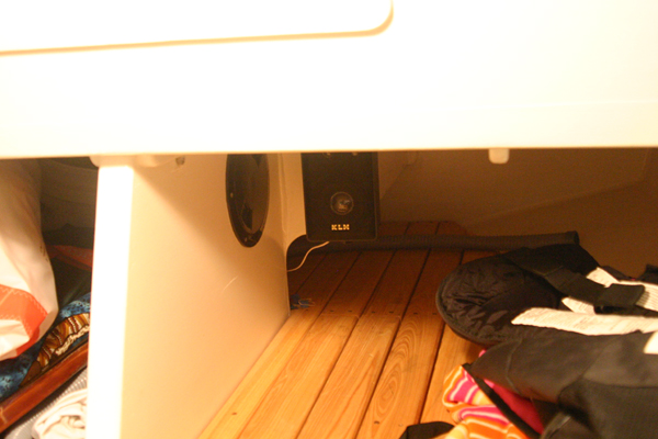

The rear speakers are mounted to the front of the footwell. Need to fasten that wire up out of the way before gear catches on it. Boats enjoy the same advantages as cars for audiophile listening---lots of surfaces to diffuse the sound. Give me a nasty Northeaster and I'll give you a lovely day at anchor reading books, listening to music, and sipping hot tea. Of course, a cheap old boombox will get you there with a lot less effort.
Rear Speakers.jpg (185.64 KiB) Viewed 59624 times

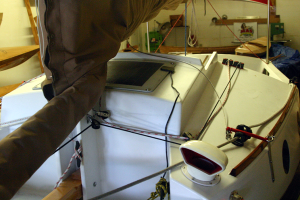

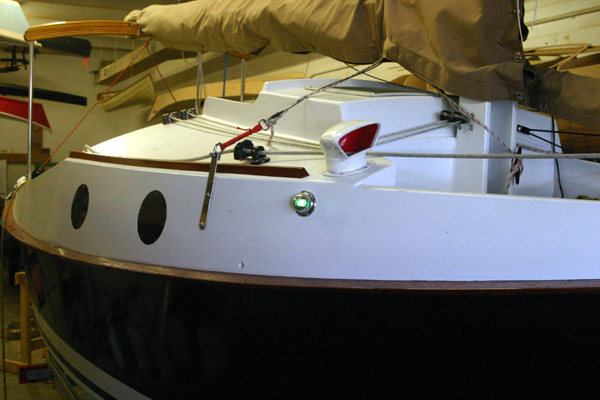

I've only got two of the three running lights installed---the port and starboard lights. They're fastened to the outsides of the Dorade boxes. I bought some clever watertight through-deck plugs to run the wires into the interior from the Dorades. The white stern light will require some fooling around with the "transom skirt."
Running Lights.jpg (251.38 KiB) Viewed 59038 times
Keeping the 12-volt battery charged up is a 10-watt solar panel fastened to the top of the companionway hood. Another one of those through-deck plugs connects it to the battery through the Dorade box.
Solar Panel.jpg (282.7 KiB) Viewed 59510 times
I see you installed some interior LED lights. Did you manage to get LED running lights as well? They would really help keep battery consumption down.
I wanted LED running lights, but they were $83.....EACH. Too rich for my blood. I got the cheapie Sea Dog brand, which have held up on two other boats that I've wired. The LED running lights were also physically quite large.
