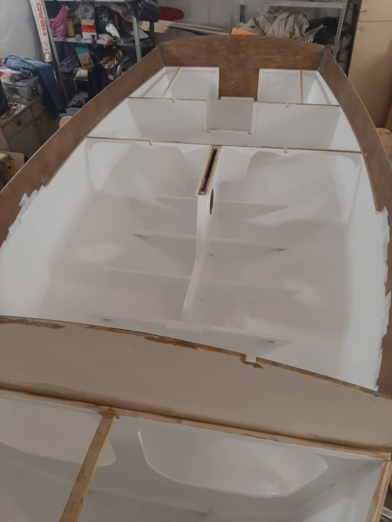

Postby Dmitriy on Sat Feb 25, 2023 10:13 am
Hello builders!
A small progress report for the month.
Forward deck and cockpit deck are glued in. Seatback frames are also glued in.
I made an addition in the bow - I glued a cleat in the center at the top between BH 2 and 1. This helped to make the flatness of BH 2 as well as additional support for the front deck.
Also added cleats on the sides between BH 2 and 1, where the manual says to make just a fillet. I have seen this with some builders.
I want to say a few words about footwell. I expanded it by 2 cm on each side. When I saw the result with my own eyes, I realized that it really takes up space in the cabin and creates an unnecessary obstacle.
20230212_174513_1 (2).jpg (66.05 KiB) Viewed 85772 times
Now I really understand that the option that Brent described will be much more practical and beautiful. Widening the footwell
I advise everyone to listen to this.
