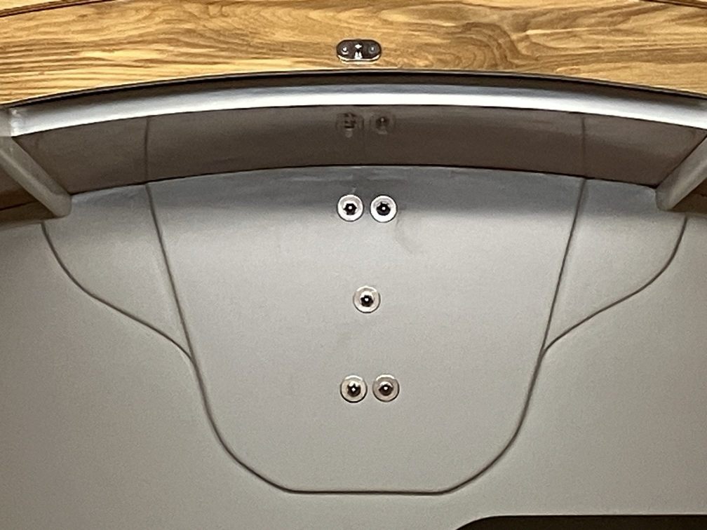

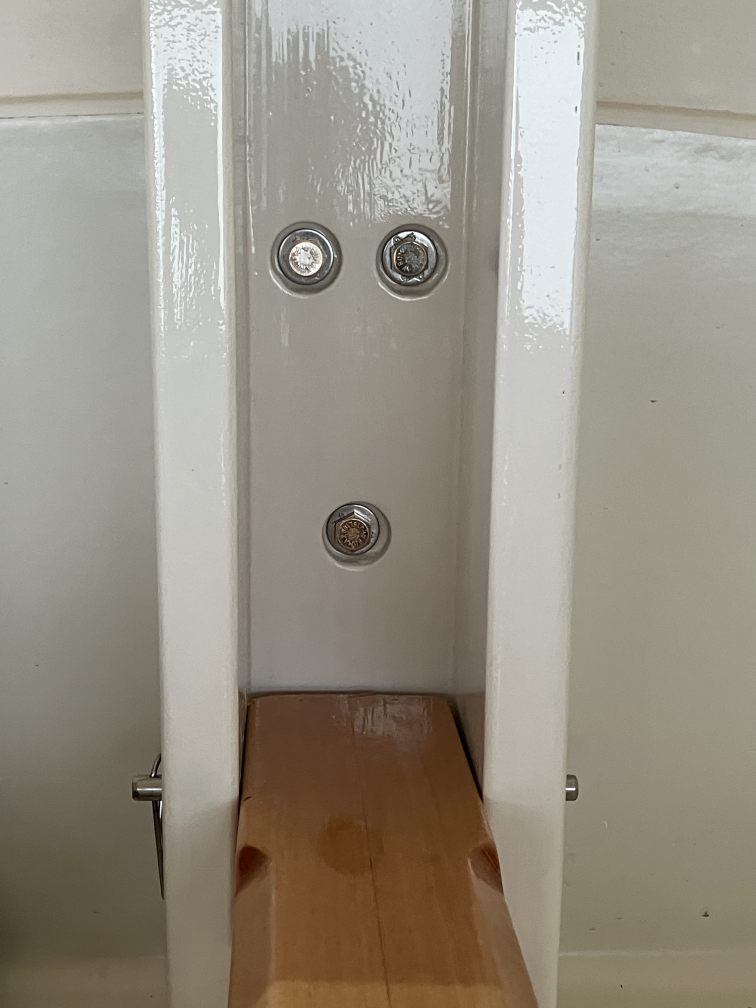

We have chosen to build the tabernacle removable. The outside transition from cabin top to BH #2 received two extra layers of glass, and two pieces of 9mm of plywood have been glued to the inside of BH #2. The tabernacle itself has been strengthened by pieces of 6mm plywood glued to its sides. It is installed via five 8mm screws that are bolted through BH #2.

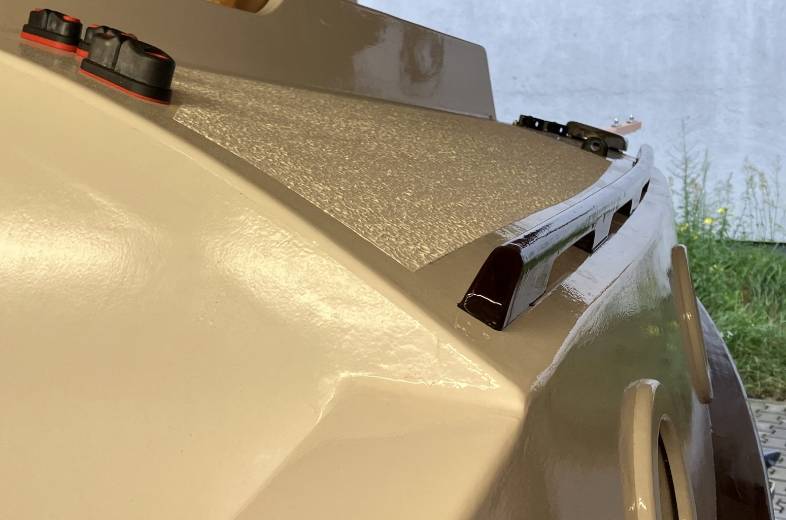

Another change has been the toerails at the cabin top. Actually, they have been converted to low profile handrails and fixed to the cabin top with marine sealant and 5mm wood screws the through roof from inside the cabin. It took some time to build but we believe this will be quite handy to attach fenders, straps from rain/sun cover, whatever ...
