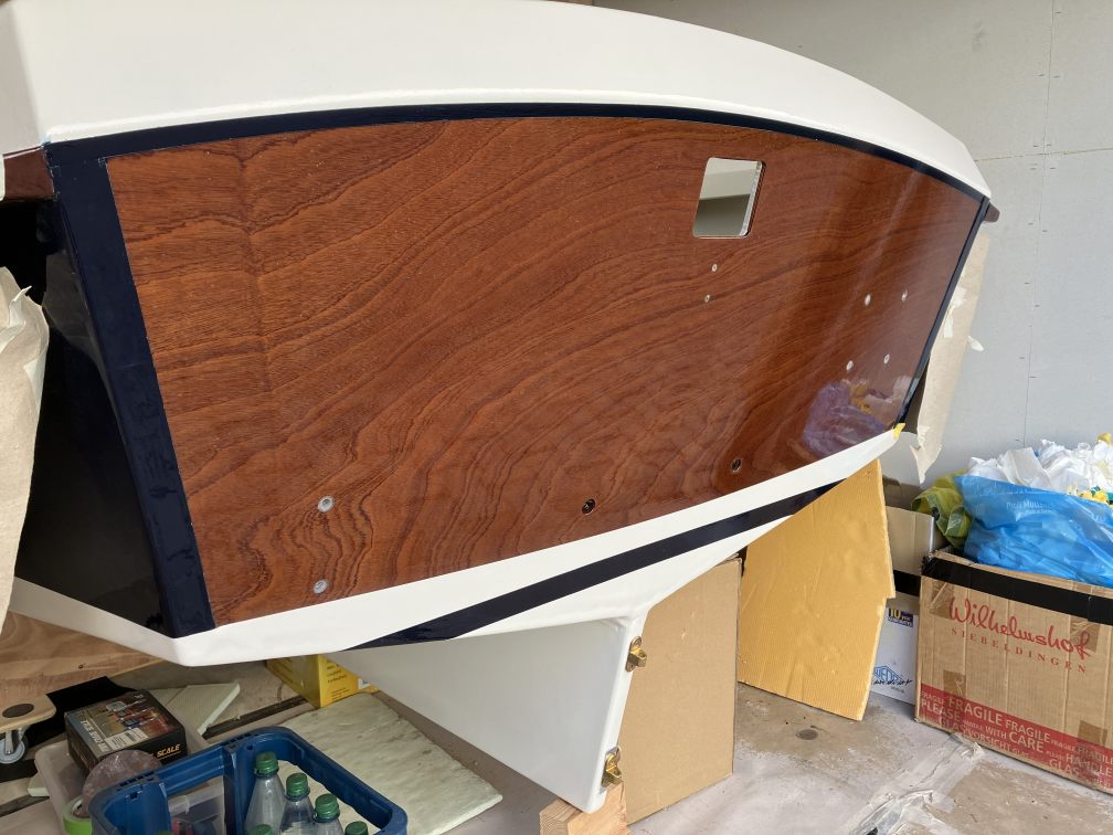

We just finished painting / varnishing the upper hull. As with the lower hull, we did go for epoxy primer, then sanding with 240 grid. This was followed by two coats of two-part paint with 400 grid sanding in between the coats. The transom has been varnished with three coats only (we are lazy) of one part varnish, again sanding with 400 grid in between the coats. We basically reused the (slightly simplified) color scheme of #PS1.
There are some imperfections, but there seems to be a general rule that with each coat we introduce a painting bug somewhere. We decided to leave it like this.
